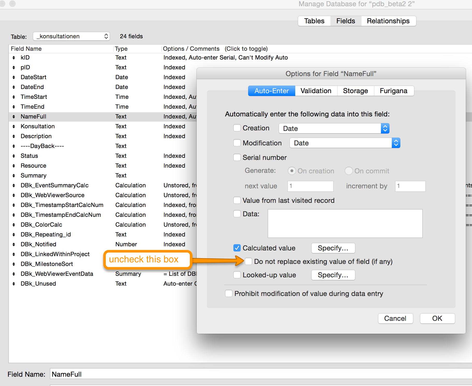

It's true that the data changes in the events and contacts table but the (contact) name in the calendar popover still remains the old one...

It sounds like there might be a problem with your DayBack setup. I'm happy to help you troubleshoot that. Would you mind sending your file to me at support@seedcode.com? Be sure to include the full-access login info.

Got your file, thanks. You're using a local text field ("NameFull") as your Contact Name. That's fine, but the problem in your case is that you have the "Do not replace existing value..." check box turned on for that field's auto-enter calculation. Uncheck that and I think you'll see the behavior you're looking for. Alternatively, you could map the name field from the related Contacts table. HTH -Jeff

PostPosted: Wed Jul 01, 2015 1:55 pm
Thanks a lot. Solved the issue.
