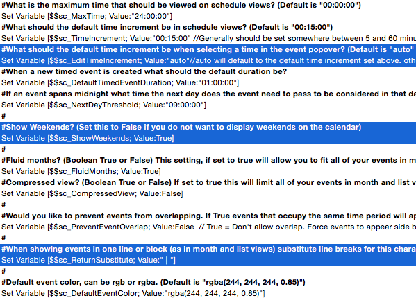

We made three small changes to the "Load Calendar Settings - On Startup" script. If you haven't modified this script you are welcome to just copy the contents of the script and paste into your file as you have been doing with the other scripts. If you made changes please add the following lines that are highlighted in the screenshot below. These script steps can be copy and pasted from the new updated file.

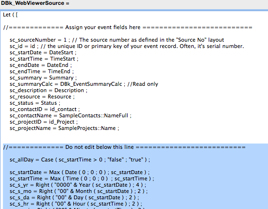

We also made a change to the field "DBk_WebViewerSource" field. This field is located in your events table (SampleEvents by default). Please locate this field in your events table and replace the content below the field mappings with the corresponding content from the new updated file. See the highlighted content in the screenshot below for what to copy and replace in your field (everything highlighted and below). You will have to make these changes to this field in all of your event source tables.
Please note that our let statement variables all start with "sc_" now. You can see this in the screenshot. If your's do not start with "sc_" please add that to the beginning of your let variables so it matches what it looks like in the screenshot (this is in the content above the highlighted area in the screenshot). If you don't have the "sc_" prefix you will get a "Field Missing" error when trying to close the calculation dialog. So simply add that prefix and you will be able to save your changes and continue.
