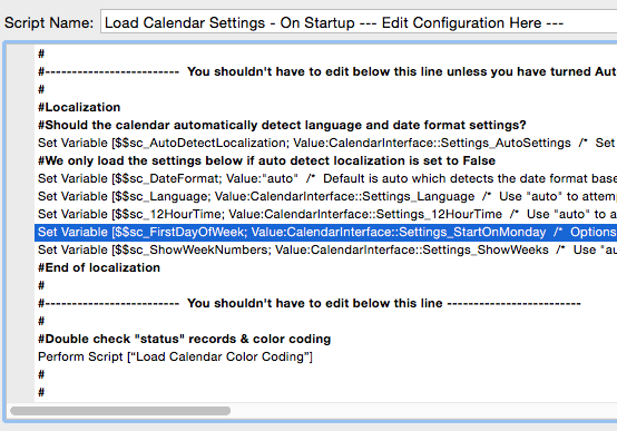

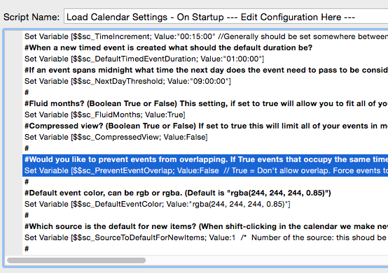

We made two small changes to the "Load Calendar Settings - On Startup" script. If you haven't modified this script you are welcome to just copy the contents of the script and paste into your file as you have been doing with the other scripts. If you made changes please copy the script step Set Variable [$$sc_PreventEventOverlap] and the script step Set Variable [$$sc_FirstDayOfWeek] from the latest version of DayBack into your file. It should look like the images below.
