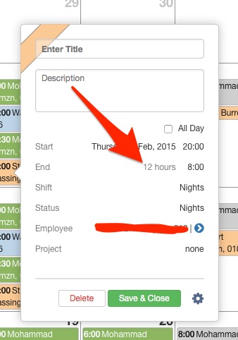

Also, where can I find the field that calculates how many hours in duration an event is? I need to use this to calculate employee's pay each month. Please see image below.

Hi Brian. The event duration (the "12 hours" in your screen shot) isn't coming from a field. It's calculated dynamically by Javascript in the webviewer UI. You could make your own field for this in the SampleEvents table. Just make a calc field that subtracts the start time from the end time, and divide by 3600 (since 1 hour = 60 seconds x 60 minutes).

Thanks for the tip, I created a calc field (DateStart & " " & TimeStart), result = "Timestamp" to account for spanning midnight and did the same for DateEnd and TimeEnd.
A third calc field subtracts the start from the end and divides by 3600 as you suggested, which works great.

I'm glad that worked out with your duration calculation. FYI, you could also use Timestamp (DateStart; TimeStart) to calculate a timestamp. I'm sorry there isn't a simple solution for a table view of the calendar. -Jeff
