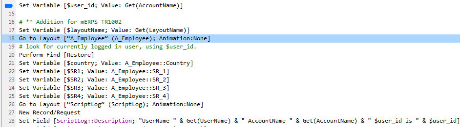

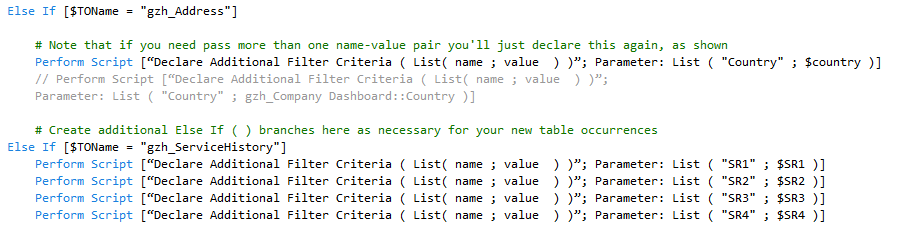

In the GZM script 'Specify User Defined Search Criteria' I use get(AccountName) to find country and service regions for the logged-in user.
The variables are then used to declare additional filter criteria
When I run a sync on the iPad, Get(AccountName) returns 'Sync' and Get(UserName) returns the User Name configured in FMGo - Settings. I would prefer not to use Get(userName) as it will complicate matters when changing iPad users.

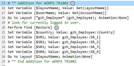

Since the user logged into GoZyncMobile is the 'Sync' user, I think you'll want to be getting the account name in the "Filter Records To Pull" script in your hosted file, rather than in the scripts in GoZyncMobile. We've got some more detailed info on this in our Downloading Found Sets documentation here: https://www.seedcode.com/pmwiki/index.p ... gFoundSets
We mention putting Get(UserName) in the GoZyncMobile file, as you won't be able to get that information from your hosted file. But the FileMaker account name is available in the "Filter Records to Pull" script because the signed in user is being used to access the data.

I have re-vamped the way I was looking for 'Service Regions' and renamed occurrences of the 'Employee' Table/T.O.'s so that they sync first.

To-day I tried using a different user from an iPad, and I keep getting the records for PaulS. No matter who I logged in as, the found set was always for PaulS
I closed down FMPA, re-started FMP Server, and tried again - same result. Looking at a log file I am creating in the hosted file I see this entry:-
"UserName Get IDS Needed For Sync PSOS - PaulS17796 AccountName pauls $user_id is PaulS"
in response to this code at the start of the 'Filter records to Pull' script. The log entry is the same no matter who is logged in. The only thing that changes is a number (17796) that increments by 2, and is reset to 2 when the hosted filed is closed and reopened.
