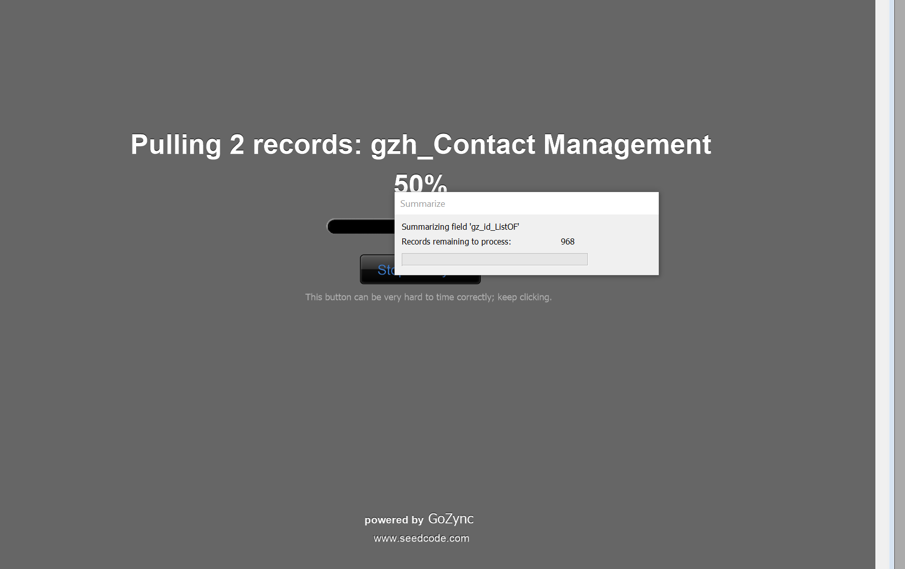

The Summarizing Dialog on desktop during sync will show how many records it is summarizing. On IPad it just shows up at the bottom of the screen as Summarizing gz_id listof
If this does not sound normal is there another script I should be checking which may have turned off PSOS?
screen shot from FM proadvanced desktop
This shows up even if no records have been changed. This is with a round trip zync.
