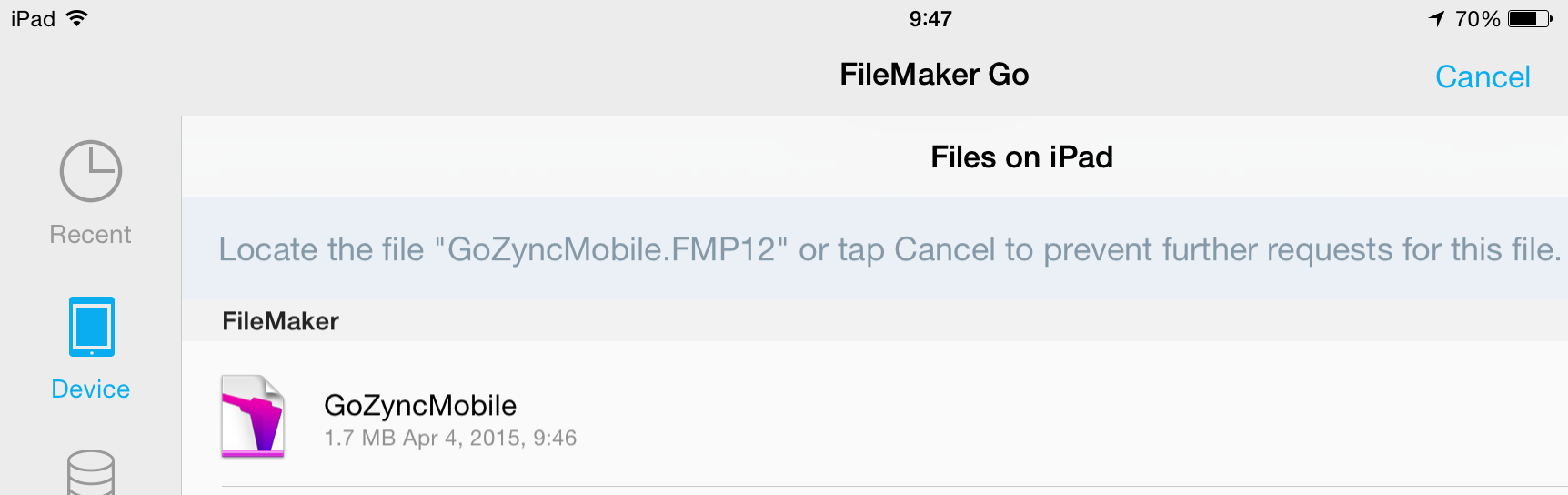

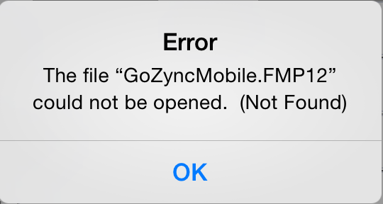

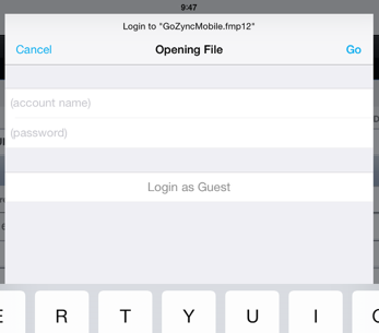

I can successfully run DemoWorx app from iPad but run into this problem when i sync from my solution.
When I run sync from my mobile app without having GoZyncMobile open in iPad, I get following three error messages in sequence -
My app does not throw this error when I run it through desktop. I am not sure where to look for problem or how to debug it.

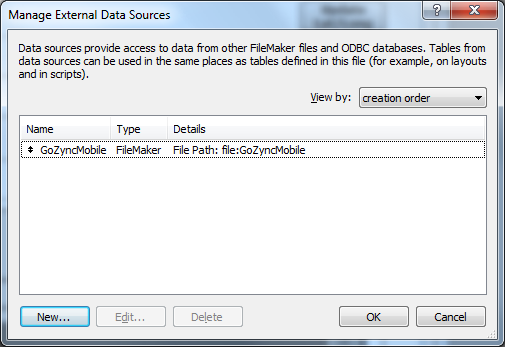

Check the External Data Sources in your mobile file. Make sure the entry for GoZyncMobile looks like this:
file:GoZyncMobile
Posts: 7
Joined: Tue Mar 12, 2013 3:00 am
PostPosted: Sat Apr 04, 2015 8:41 am
Yes. it does. I have double checked it. Also compared it against DemoWorx copy.

Ahh.. a very simple thing was causing this mishap - some of my files used UPPER case file extensions (.FMP12 instead of .fmp12). I fixed it and everything works like a charm!! :D
