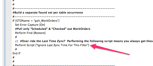

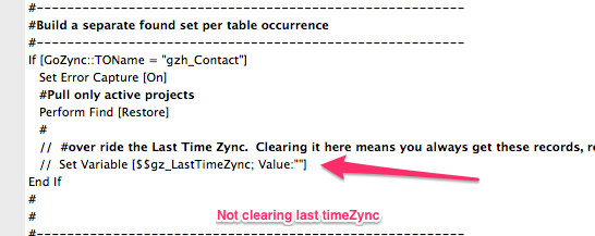

Hi Rick. The two files are using different filter behavior when syncing. Each filter gets to decide whether LastTimeZync is ignored or not. In QuickContact the filter does NOT ignore LastTimeZync. In WorxMobile, the filter ignores LastTimeZync. HTH... Jeff
Filtering in WorxMobile (GZ5)
Filtering in QuickContact (GZ4)

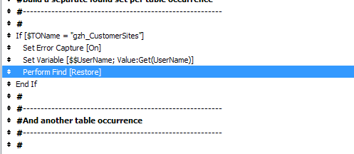

I understand that in the Filters, but I am not ignoring the Last Zync Time. Going through the GoZync scripts, I can not see anywhere that checks for the Last Zync Time to find what needs to be pulled, Instead this just pulls all rows.
Attached is the filter that is being performed

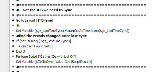

On another note, the attachment is a snipping from the script Get IDS Needed for Sync PSOS. In the section "#find the records changed since last sync" but there doesn't seem to be anything in the Constrain Found Set, is this correct?

PostPosted: Fri Jul 11, 2014 10:49 am
The "Custom Field Mapping: Transformation and Hooks" script is for setting fields, not filtering. I think that Constrain Found Set step is broken in your file. I'm attaching a screen shot of how it's set up in the stock WorxHosted file. HTH... Jeff
