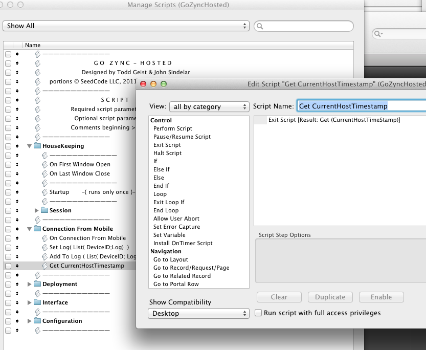

1. Create a new script in GoZyncHosted called "Get CurrentHostTimestamp" containing just one step:
Exit Script [Get (CurrentHostTimestamp)]

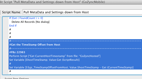

2. Add these three steps at the very end of the "Pull MetaData and Settings down from Host" script in GoZyncMobile:
Perform Script ["Get CurrentHostTimestamp" from file: "GoZyncHosted"]
Set Variable [$hostTimeStamp; Value:Get (ScriptResult)]
Set Variable [$$gz_TimeStampOffsetFromHost; Value: $hostTimeStamp - Get (CurrentTimeStamp)]

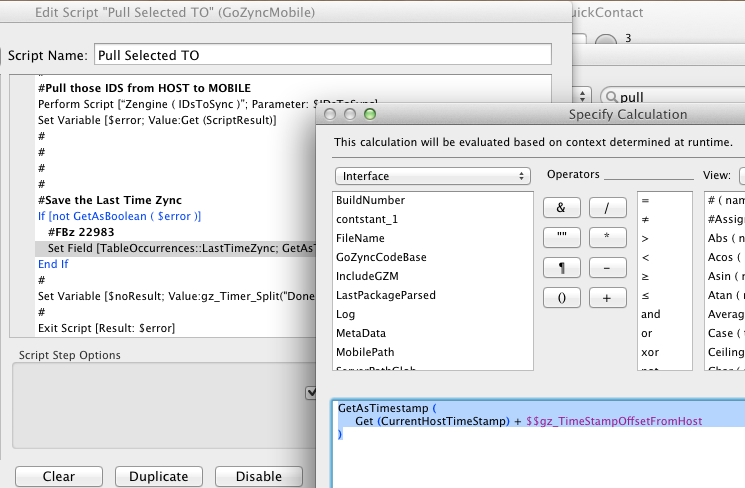

3. Edit the Set Field calculation toward the end of the "Pull Selected TO" script in GoZyncMobile, following the "Save the Last Time Zync" comment, so it looks like this:
GetAsTimestamp ( Get (CurrentHostTimeStamp) + $$gz_TimeStampOffsetFromHost )
That's it. I'm also attaching screen shots of each of these script edits. Let me know how it goes.
