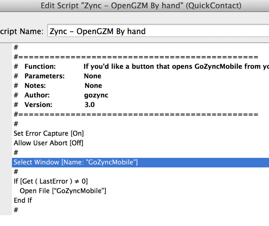

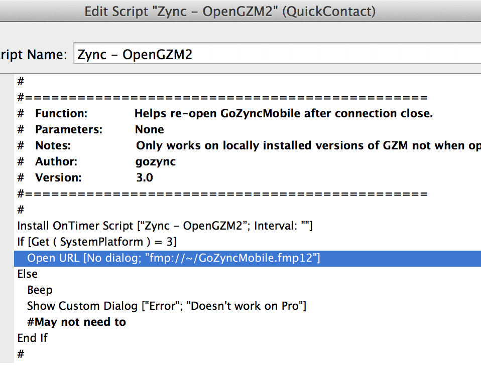

Also, although GoZync doesn't officially support multiple versions of the GoZyncMobile file, you could actually do that with a few modifications. The "GoZyncMobile" file name is hard-coded in several scripts in the mobile file (QuickContact), so you'll just have to find all of those references and update them to reflect whatever you change the name of the different GoZyncMobile files to. I know it's in the "Zync - OpenGZM2" and "Zync - OpenGZM By hand" scripts (see attached screen shots). It may be elsewhere, too. Like I said, we don't officially support that scenario so you'll just need to test everything to make sure it works. Let me know if this is something you'd be interested in having us do for you and I'll get back to you with an estimate.
