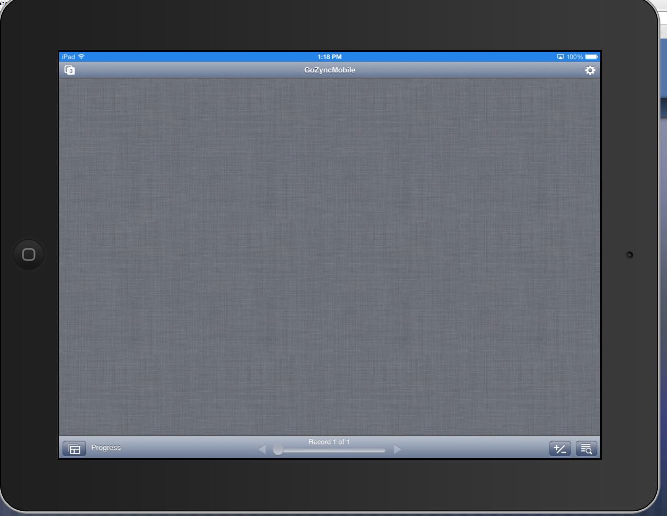

I notice I don't get any feedback stating that GZM is working as it brings down the new file. I'm on the "Progress" layout that appears to be blank / not really open (see attached screen grab). Perhaps there is a progress display that will arrive later? It's looked this way for the past 30 minutes.
So, I'd like to know
1. how where to look to modify the process so I can give the user some feedback, if possible; and
2. If, in your opinion, my file is just too large for this to be practical.

Hi Maida. I'm glad you enjoyed the webinar! The layout that appears while the mobile file is being downloaded and installed is modifiable, so you can change it to look and behave any way you'd like (add a user-facing message, etc.).
Your mobile file may be too large for it to be practical to use the built-in update mechanism. I would advise finding a way to reduce the size of the file that will need to be updated. If there are lots of images, or data that doesn't change very often, perhaps consider splitting the mobile solution into multiple files to minimize the size of the file(s) that need to be updated this way. HTH -Jeff
