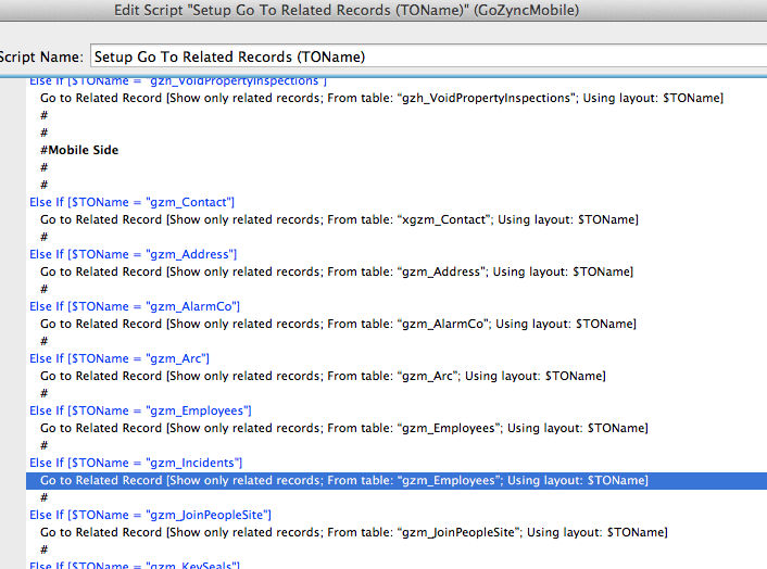

Thanks for sending your files. I think I found your problem. The "gzm_Incidents" branch in your GTRR script is using the wrong relationship (see screen shot). Fix that and try synching again.
Screen Shot 2013-10-17 at 12.53.09 PM.png (103.06 KiB) Viewed 11232 times

Excellent, many thanks Jeff...
