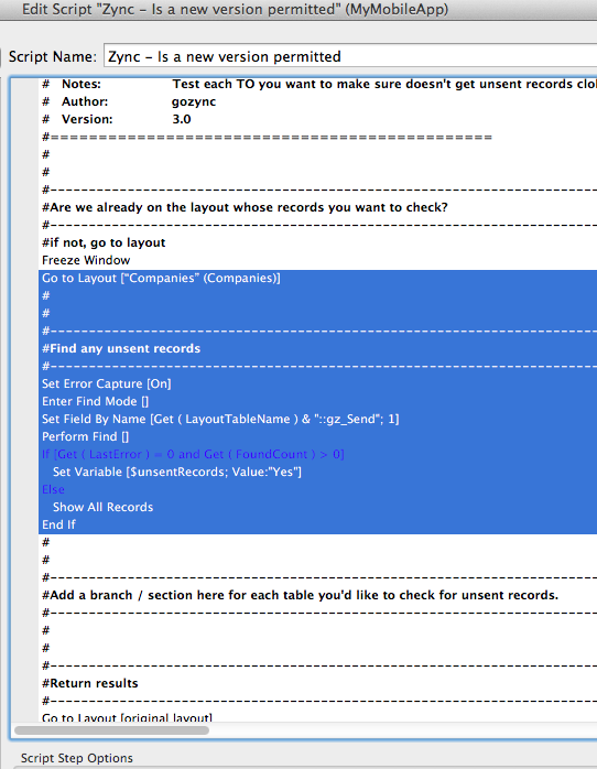

The script "Zync - Is a new version permitted"
I'm guessing that this checks the Mobile file to see if any records need 'pushing' to the Hosted file before overwriting the Mobile file with an update. Is this correct?
If yes, I only have two TOs that push data upstream so what do I need to add to the script?

PostPosted: Tue Oct 15, 2013 12:32 pm
You'll need to add a branch to the "Zync - Is a new version permitted" script for the second table you want to check. Just duplicate the steps that you see highlighted in the screen shot and change the layout in the "Go to Layout" step.
Screen Shot 2013-10-15 at 2.26.42 PM.png (78.42 KiB) Viewed 10559 times
