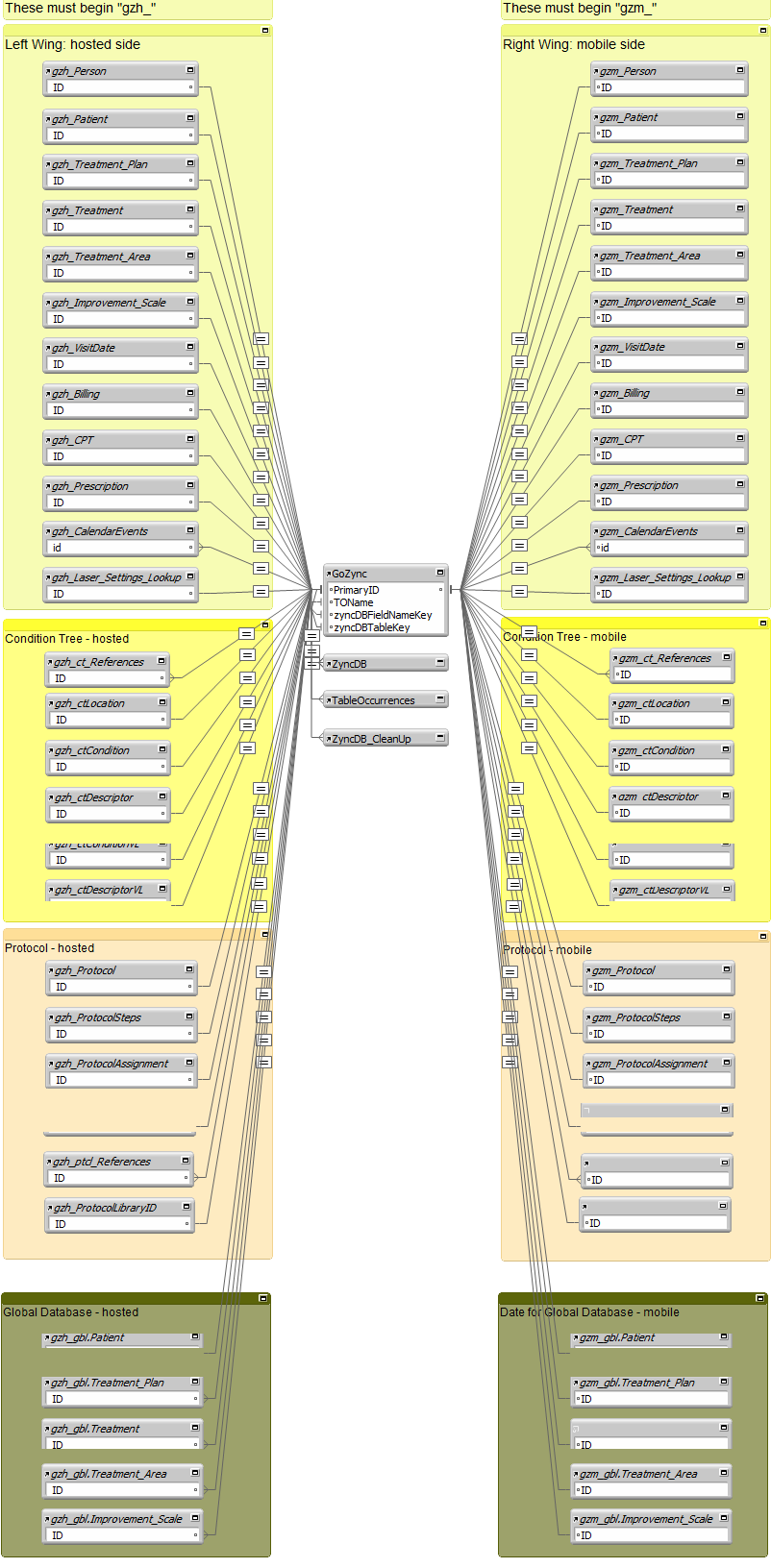

I suppose I could download a fresh 4.052, though I do have a LOT of TOs (see attached image; the anomalies in the image are where the screen capture app hiccuped during the vertical scroll). It would take me awhile to set everything up again, but maybe my manual upgrade wasn't 100%. I was looking for an easy solution first!

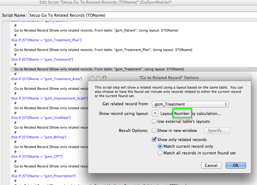

Hi Aaron. I found the problem and it's easy to fix. It's also an easy mistake to make, though not so easy to find. The "Go to Related Records" steps in the "Setup Go To Related Records (TOName)" script in GoZyncMobile all use the "Layout name by calculation..." option. The GTRR in your Else If [$TOName = "gzm_Treatment"] section is using the "Layout NUMBER by calculation..." option (see attached screen shot). Just switch that back to "Layout NAME...", save the script and the sync should work. I didn't check all of the GTRR's in that script, but you might want to do that if you see any other similar problems with synching. -Jeff

PostPosted: Wed Sep 11, 2013 5:38 am
So far so good. Records appear to be syncing logically now. There were a total of two GTRR steps that needed to be changed from 'number' to 'name'. Those must have been mis-clicks, since name does make more sense.
