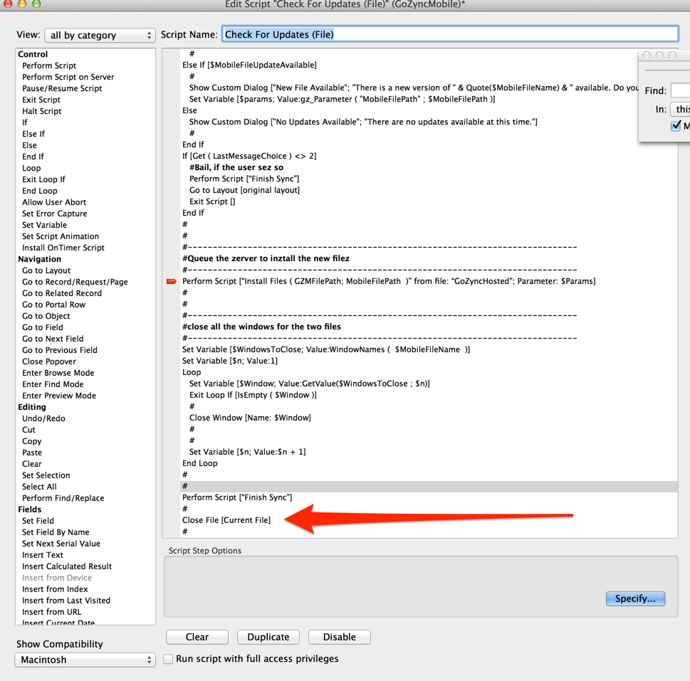

To fix the "file is locked" problem, you need to add a "Close File [Current File]" step at the end of the "Check For Updates (File)" script in GoZyncMobile (see attached screen shot).
Jeff

I'm seeing this same error in 4.x and I notice that that line is missing from Check For Updates. Is that purposeful? Any correlation? I'm adding it and testing right now....
PostPosted: Wed Aug 07, 2013 6:03 pm
Hey Joe,
That line wasn't omitted on purpose and you'll want to add close file to the end of Check for Updates as Jeff shows in his screen shot.
