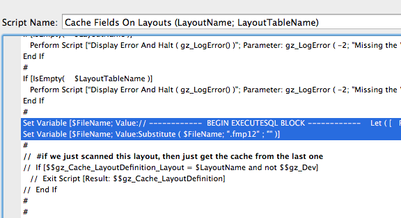

GoZync syncs separated solutions just great and usually folks will put the sync layouts in the data file. But you can put sync layouts in the interface file, provided you modify a couple scripts...
In GoZyncMobile, find the script "Cache Fields On Layouts (LayoutName; LayoutTableName)". After the first three If() statements you'll see a line where we set the variable $FileName. Replace that line with the two lines shown in blue below:
The second line you can probably read, but the calc for the first one can be copied from here:

In GoZyncHosted, the idea is the same but the script and calc are slightly different. Find the script "Get Fields { FileName } (LayoutName; LayoutTableName)". After the first three If() statements you'll again see a line where we set the variable $FileName. Replace that line with the same two lines shown in blue above, but for the first line's calc, use this:
