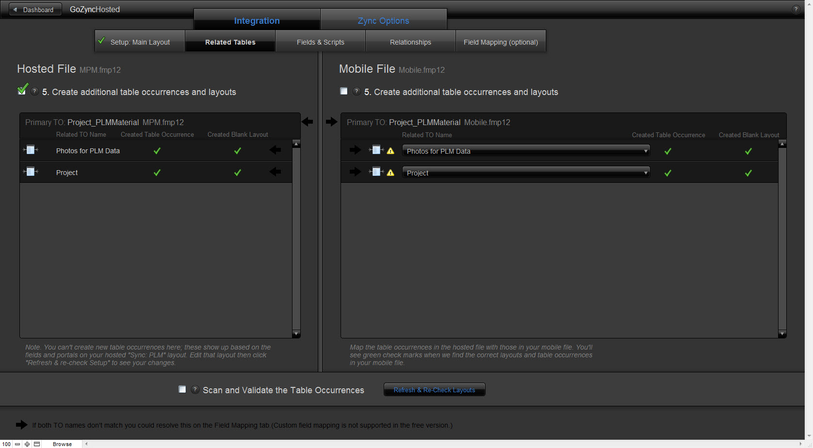

No check mark next to 5. Create additional table occurrences and layouts.
I have two links under this section. Both have check marks for Created Table Occurrence and Created Blank Layout.
Error on bottom:
Map the table occurrences in the hosted file with those in your mobile file.

Hey Jay,
I don't understand, sorry. If you have related fields on the layout then you need to create relationships from the GoZync TO to the related table in both the GZHosted and GZMobile from the PrimaryIDGlobal to the related TOs primary key. If you have the checkbox on the hosted side, then it's correct in the GZHosted file and you just need to create the same relationship in the GZMobile file.
If you want to put a screen shot up here, then that might help.

Thanks for your reply Jason.
Per your request, I have attached a screen shot.

Hi Jay,
So the Conditional Formatting that exposes that caution sign is
// Test Passed
not IsEmpty ( FilterValues ( TableNames ( AllTableOccurences::FileName_Mobile ) ; RelatedTOs::TOName_Mobile ) )
So I think it could just be the result of the the Mobile Files not being open, otherwise the names don't match exactly.
