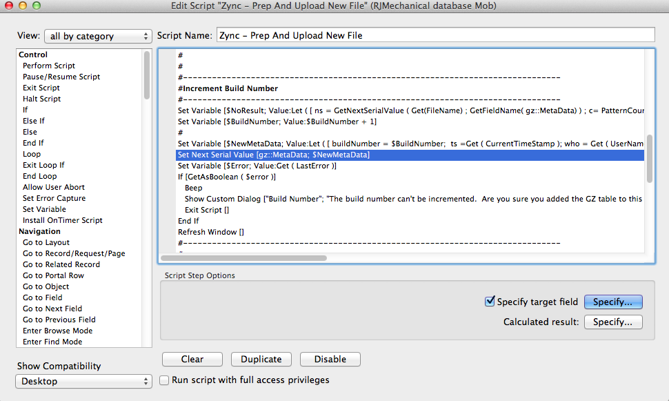

When you've got a new version ready for your users, run the script "Zync - Prep and Upload New File" that you imported into your file as part of the integration process
Ok, i have a new version ready for my users. Now i try to run the script "Zync - Prep and Upload New File", but this message appears: "You can´t run the script when the file is hosted". This is disturbing! :-) I am editing my hole FM databases with FM Pro 12 Advanced on a Windows 7 PC. The DB´s are hosted by FM Server 12 Advanced. , so i work with the DB´s remotely. This means that my "master" mobile file is "hosted" respectively stored on the FM Server. It has to be distributed from there.
EDIT: Ok, i have to close the mobile file on FM Server an download it to my PC. Now the script complains; "The Build Number can´t be incremented. Are you sure you added the GZ Table to this file". The GZ Table is there, what can be an other reason for this message?

i have my mobile file and the GoZyncMobile file local, but running the script Zync - Prep and Upload New File still results in "The Build Number can´t be incremented. Are you sure you added the GZ Table to this file". How mentioned before, the gz table is there. GoZyncMobile can see the hosted files. What can be the reason for this?
EDIT: I found the reason, the gz table had to be specified in the script "...Prep and Upload...". Now the distribution of a new mobile file works. Sadly not so comfortalbe as i expected, but still adequate.

We throw that error if we can't set the field MetaData in the table GZ you pasted into their file.
>It could be that the field isn't there
>The logged in user doesn't have permission to set it because "any new table" was set to not being able to modify in the privilege set you're using.
>The field reference in the script is broken because the script was pasted in before the table was. The part of the script is highlighted below, so take a look there:
Let us know if that helps.

Unfortunately i have still another problem. The Script "Prep and Upload New File" runs without an error, but the build number becomes not incremented. What can be the reason for that? Do you need any further Information?

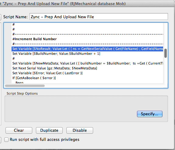

PostPosted: Fri Nov 16, 2012 8:38 am
Hi Torsten,

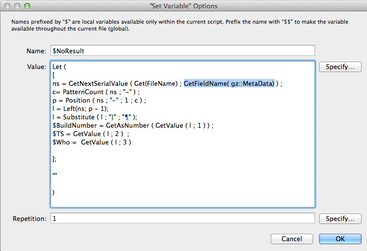

Probably have the same thing going on in the calculation a few lines up from where you're setting the field in the calculation that sets $NoResult here:
it should look like this and my guess is that the gz::MetaData reference is broken:
Those are the only two gz references in this script.
FileMaker is touchy about it's dependencies. So if you paste in script that references a field/table/layout that's not there it breaks and stays broken even if the missing piece is added back in later.
