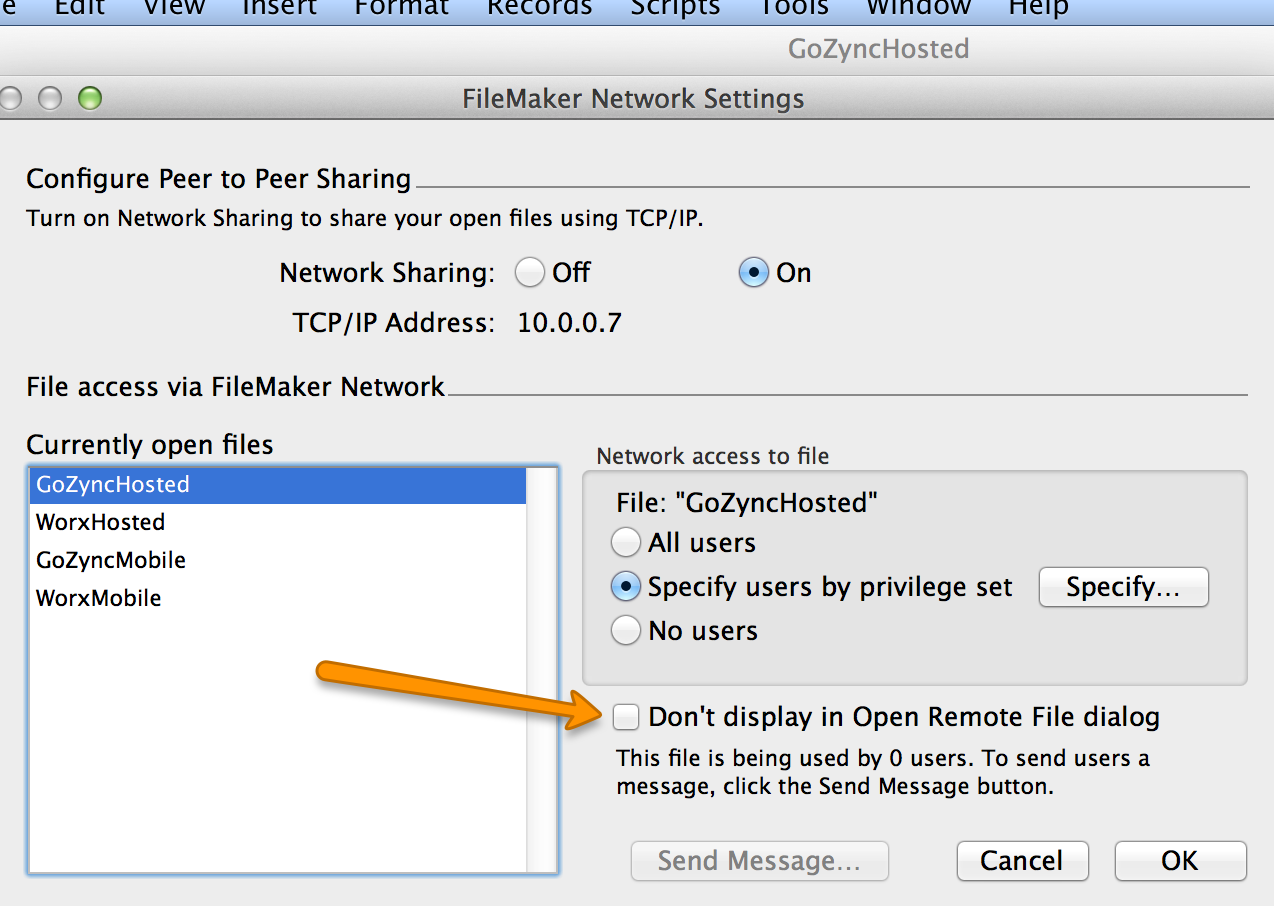

Sorry to sound like a broken record, but now that I have GoZync 5, how do I configure the GoZyncHosted file's sharing options to select the "Don't display in Open Remote dialog" checkbox?
PostPosted: Thu Aug 07, 2014 11:15 am
Log into the GoZyncHosted file as "administrator", then from the File menu select Sharing > Share With FileMaker Clients. Select "GoZyncHosted" from the "Currently open files" list, then check the "Don't display in Open Remote dialog" check box. HTH... Jeff

Thanks for the help. I thought I had already logged in with those credentials before posting my question, but obviously I had not.
