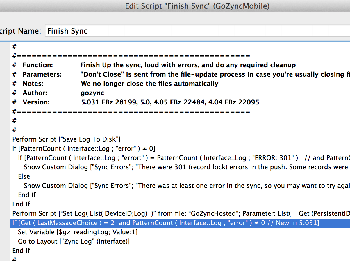

Woops! You're right, sorry about that. I was looking at the files you sent in previously. I'll open your GZ5 files and try to figure out what's causing the "File is locked" error today.
PostPosted: Thu Jul 24, 2014 4:09 pm
Ok I figured it out. There is one small change in GoZyncMobile that I don't believe we included in the instructions for manually updating an earlier version of GZ5 (we will add it!). Edit the If[] condition in the "Finish Sync" script as shown in the attached screen shot so it looks like this:
Get ( LastMessageChoice ) = 2
and PatternCount ( Interface::Log ; "error" ) ≠ 0 // New in 5.031
As you can see from the comment, that second line is new in version 5.031. Make that change and let me know if that fixes the problem for you.
Screen Shot 2014-07-24 at 6.05.25 PM.png (189.11 KiB) Viewed 38098 times

PostPosted: Fri Jul 25, 2014 1:41 am
Hi Jeff,
That is brilliant, our mobile file is now successfully updating.
