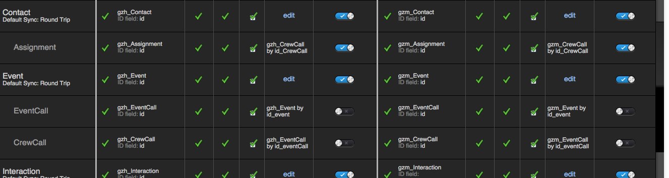

Possible Bug. Note in attachment that Assignment has not sorted properly. It is a child of Crewcall, Crewcall Child of EventCall, which is a child of Event
And yes, I do know that my current setup may be sync overkill. Still digesting all the options....

Hi Darren. I think you're expecting your Assignment table to appear below CrewCall, in keeping with the hierarchical nature of all of the parent-child relationships you have set up in your solution. The reason it's not sorting that way is that GoZync doesn't support synching more than one level deep. You can set up related synching for all three parent-child relationships you outlined, but each child table will only be synched along with its immediate parent. So when you explicitly sync Event, EventCall will also be synched, but CrewCall and Assignment will not. When you explicitly sync EventCall, CrewCall will also be synched, but Assignment will not. To sync Assignment, you'll have to explicitly synch CrewCall (or just sync Assignment independently). HTH -Jeff
