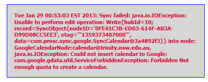

But I came across a problem that I believe relates to Google placing a limit on the number of calendars you can create on any given day. I'm trying to set up individual calendar feeds for over 2000 user in an client's organisation.
Error as per screen shot.

Right, I don't think Google's going to allow that kind of capacity whether it comes from a single or multiple pairings.
As soon as you Zulu is installed and you Publish your first CalendarList record, Zulu starts behaving like a CalDAV/iCal Server so you can hit it directly without using Google at all. This is actually a more stable set up that Google as their's no syncing involved, FileMaker Server becomes the single data source.
