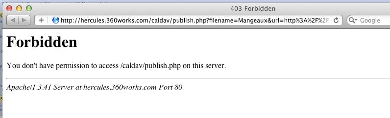

I am getting the following error when attempting to publish the calendars:
In safari:
Forbidden - you don't have permission to access /caldav/publish.php on this server
This occurred after running the publish script. I thought I had perhaps used the wrong password, so I reset the safari and emptied the cache and tried again - same error.
See attached.

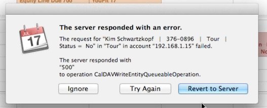

Once again having some Zulu issues. This time the client has upgraded their server to 10.8.2, and we upgraded FMS to 12. Zulu 1.3403
I can get one calendar to function after deleting all of the list records except 1 (and then publish), however when I add another calendar list record, change the filter value and display value, I get an error in iCal:
The server responded with "500' to operation "CalDAVWriteEntityQueueableOperation"
see attached.
Actually this message was generated trying to move an appointment. Refreshing the calendar will also generate the error, without specific reference to the one record.

PostPosted: Fri Mar 15, 2013 9:53 am
Hi Darren,
2 things that are common to trip you up here. You want to make sure you duplicate the initial ZuluCalendarList record so that the zulu_Properties value is the same for all of the records. zulu_Properties is where the field mapping is stored. You also want to make sure that each one has a unique UUID value. We clear this by default, so if you duplicate them, you need to make sure that field gets populated. In 12, you can just change this to the Get ( UUID ) function set to re-evaluate so it runs when you duplicate them. I've been meaning to add that to the 12 sample file :oops:
If it's not those, shoot me your log from the zulu/admin page and we'll see what it says. A 500 error means you're connecting fine to the file, which is good, it just doesn't like the data it's getting.
