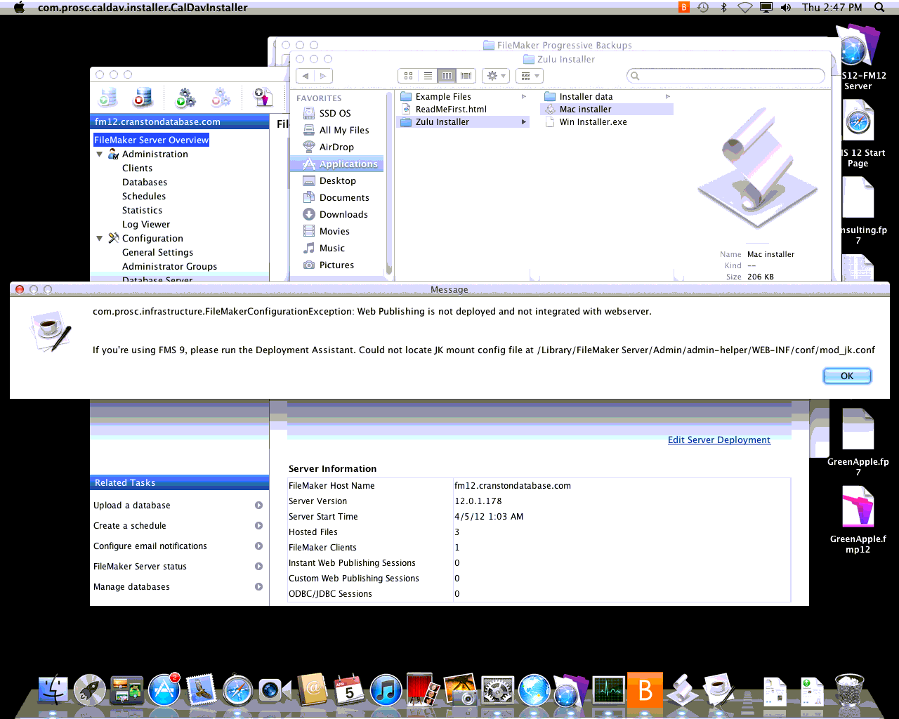

HI. I'm attempting to install Zulu on FMSA12. It's a fresh install of FMS12 running on MacOS10.7.3 Server. FMS12 appears to be running normally. Database server and web publishing are both working without any errors. I downloaded the current build of Zulu 1.313 from the website.
When I run the installer I get this error: com.prosc.infrastructure.FileMakerConfigurationException: Web Publishing is not deployed and not integrated with webserver.
Web Publishing is deployed. All the FMS Technology Tests pass. Also I did check to make sure that XML web publishing is enabled.
Any help would be appreciated.

You'll need a new installer for 12 as they've moved some things in FMS. All the details you'll need are here (including where to download the installer): http://www.seedcode.com/filemaker12.html

Hi. John. I had downloaded the installer from the page you specified. The FileMaker 12 page links back to the main downloads page. The installer on that page is what I downloaded.

I downloaded the 1.315 version from the Downloads page and that installed without any errors.
