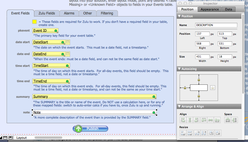

I am using Zulu to sync my calendar to iCal and Google calendars. Everything is working fine except that I cannot get the description field to sync. I get all of the event parameters except for the description field. I would like this field to go into the notes field on iCal if possible. The fields all appear to be mapped correctly. Where should I start looking? Thanks.
I have now tested it from iCal to Filemaker by entering information into the note field in iCal and it did put that info into the Filemaker calendar description field. But it will not go from Filemaker to iCal.

We have it labeled as Note on the sample file mapping page, and it has an object name of description, so that's the one you should map. You do need to republish the calendars if the field mapping changes, so that might be the issue as well.
