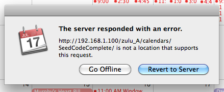

This makes me think that I should be able to send invitations from a Zulu hosted calendar entry if that event is created on the FileMaker side, and then the invitation is sent from the iCal side. But that technique doesn't seem to work. After creating the event on the FileMaker side, I can open it in iCal, edit it, and add attendees. The send button even activates so I can click it, but then nothing. The invite doesn't get sent. In iCal 4 (Snow Leopard) I get no error. In iCal 5 (Lion), iCal responds with an error dialog ("The server responded with an error. The URL http://servername/zulu/calendars/FILENAME/ encountered HTTP error 404. Make sure the URL is correct."). Perhaps this is an http vs https issue?? I have zulu configured to serve up my feeds via https and this dialog seems to be looking for a http destination.

From Google, yes, but not from iCal. When I attempt from iCal in SL I get the following error:
This is something we're hoping to look at, but don't have anything firm.
