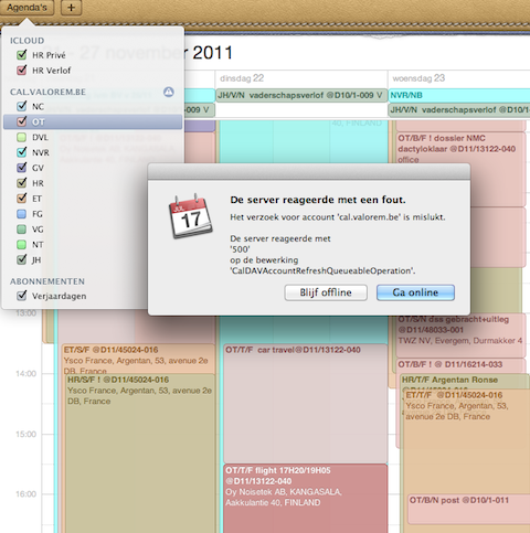

Still got some problems here though. I upgraded Zulu. Creating a Zulu account in iCal wasn't a problem, however the account doesn't work. In the calendar list it looks like the image below.
And as for Zulu on iOS 5 devices, mine refused to create new accounts.
Neither iCal under Lion nor iOS 5 accepted that I include http:// in front of my IP address.
Untitled.tiff
Untitled.tiff (14.32 KiB) Viewed 76889 times
PostPosted: Wed Nov 09, 2011 9:13 am
Hi Geoffrey,
Sorry to hear that. I think what you're seeing isn't a problem with Zulu and Lion, but a continuation of some of the problems we've seen with you file before: bad primary keys, permissions issues, etc. I'll send you an email directly with some ideas for your specific situation.
