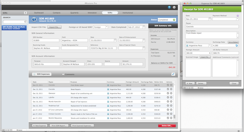

I have layouts that contain a number of portals to display data. A user can click on an individual row to have a detailed pop-up layout for modifying data and see all of the fields. If a user does a search, how can I get them to the main layout and then to the pop up? If not, how do other users display the data without having to create another special layout?

Thanks for the quick response. I have attached a sample layout showing on the main screen an area where you would see a list of receipts with the basic info in a portal. Then the green header window is actually a data entry pop-up window to make modifications or when the user creates the new entry. As you can see it does have it's own layout, but it is completely isolated from the actual main work window which contains navigation, etc. So I am trying to figure out how to represent the search results in a way that the user can navigate to and review the data without having to create multiple search results windows.

Nice looking stuff. Arriving at the green pop-up window after clicking on a search result is easy: just specify that layout when you config SearchResults. If you won't want to show search results in a new window, that's easy too: edit the script "Search" and you'll see a comment about half way down for showing results in a new window.
What *may* be tricky is showing your green window in a pop-up if your results are shown in the main app. To do that, edit the script "Integration Settings" and place a New Window command before the relevant GoToLayout step for those layouts that should pop into their own window (this section is after the comment "Change each of the Go To Layout steps below...").
