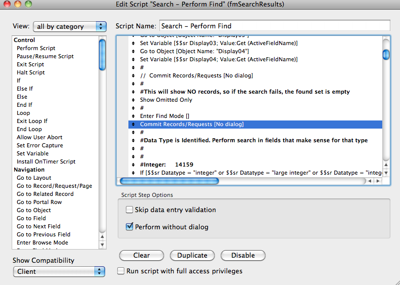

Hi Hedrich,
I think you've discovered a bug, but I think I have the fix. Even though you don't have the Unique ID set up as search field, that's actually the active field when the search process begins (first item in the tab order), so if the first Go To Object step fails because the item has been removed, then it keeps it's focus on the primary key field and inserts the search string into the Unique ID field. I'll confirm this with the developer, but it looks like adding a Commit Record/Request step after entering find mode boots you out of the Unique ID fields and prevents it from being included in the search:
Search Perform Find.png (131.14 KiB) Viewed 57849 times
I'm pretty sure that's it, but please let us know.

PostPosted: Wed Dec 21, 2011 4:20 pm
OK, I just gave it a shot in my solution but that did not resolve the issue for me. It still seems to search on the Unique ID fields on those two tables.

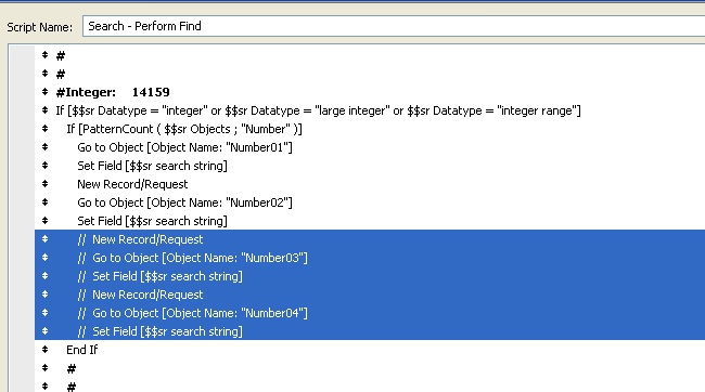

Posts: 30
Joined: Tue Oct 06, 2009 1:51 pm
Location: Austin, Texas
PostPosted: Thu Dec 22, 2011 7:53 am
I tested some more with the script debugger. In the fmSearchResults layout templates, there are only two Integer fields (Number01 and Number02) included. But the script is trying to process four. So if I supply an integer value as a search string, the script is going to try to go to an object (Number03) that doesn't exist and that is when it ends up on the UniqueID object. It only turned up for me in these two tables because they have lower starting primary key field values than the other tables in the solution. I think the main thing is that, unless you don't mind search results that include a search on the primary key, it's important that the number of objects of each data type on the search layouts matches the number of objects of that data type referenced in the script, even if those objects aren't linked to an actual field. Otherwise the UniqueID field will likely be included in the fields to search.
So in the script I just commented out the references to Number03 and Number04 and all is well. If I ever need to search for more than 2 integers, I know what to do. :)
