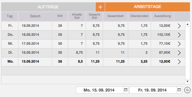

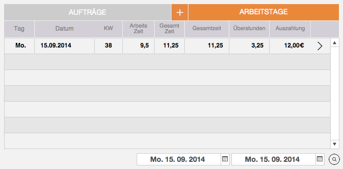

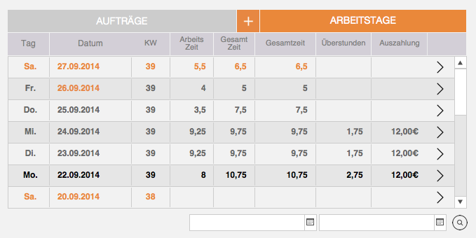

Here are the screens from my old solution
Bildschirmfoto 2014-09-25 um 19.42.26.png (50.38 KiB) Viewed 41833 times
Bildschirmfoto 2014-09-25 um 19.42.09.png (32.05 KiB) Viewed 41833 times
Bildschirmfoto 2014-09-25 um 19.41.54.png (50.02 KiB) Viewed 41833 times
