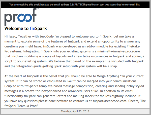

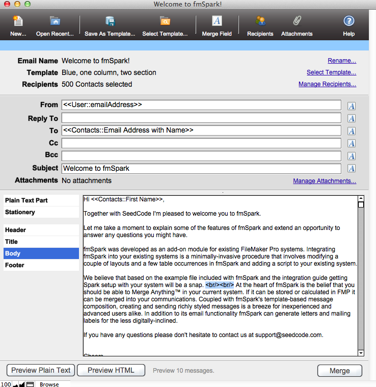

PostPosted: Tue Apr 23, 2013 11:59 am
So there's two areas in FMSpark for text, the Plain Text option and the the HTML Regions. For the Plain Text option, ¶ should work fine, but for the HTML part use <br/>. See below:
