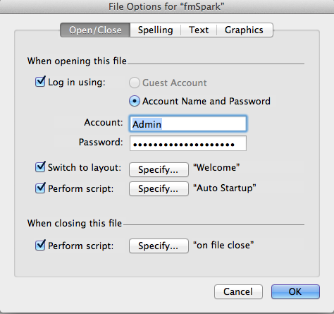

Boy, not sure. Is the user wrong or empty?
The process is pretty simple, and just writes the Get (AccountName) to a global field (g_AccountName) to match with the user. I'd make sure there's no Auto-Login set on the FMSpark file, so folks have to go through the authentication process. The default is Admin, so make sure that's been disabled.
Screen Shot 2012-02-14 at 10.10.07 AM.png (52.7 KiB) Viewed 35538 times
The global field should persist through the whole session, so not sure how it's getting lost. Even if FMSpark is closed, when re-opening it should re-authenticate and write the value.

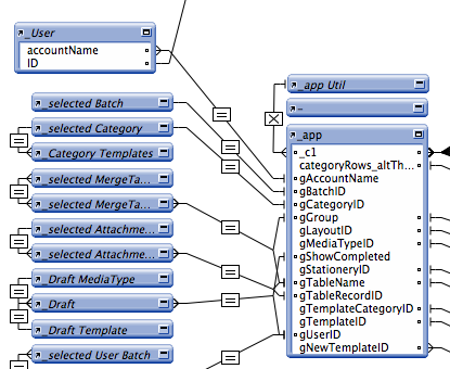

The User data itself lives in the FMSparkData file, so if that file can't be accesses for some reason, then the user data won't be available, so checking the log-in account settings on the data file might help as well. Here's a shot of the graph of how the global field is used in the relationship with Users to pull the data:

I have checked the fmSpark File Login settings and indeed we had there the tick for Administrator. Mayb this is were it gets confused sometimes, because it is not a permanent issue. I have removed the tick and will see, if this makes a difference and let you know.
