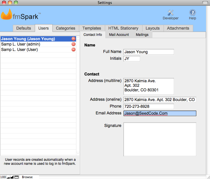

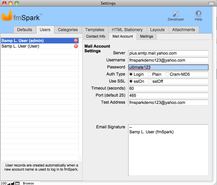

Typically we'll see an SMTP error if mail.it can detect an issue. Make sure that you've got the settings tied to the account you're using on the Users tab in set up. A common problem we run into is folks update the default tab, which is only for new accounts, but not the correct user settings like the last image I posted.

PostPosted: Thu Aug 18, 2011 1:05 pm
So that's a Mail.It error. I checked their manual and the additional detail is:
"SMTP server does not know sender or you didn’t specified sender at all"
So either Cox doesn't like the "From" address you're specifying or there's no "From" being specified. If you're using FMSpark's "Samp L. User" then it should be "fmsparkdemo123@yahoo.com" but if you're using a new account you may want to make sure the e-mail address is filled in.
