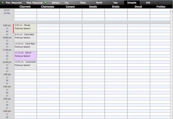

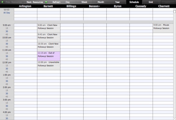

OK - here are two images.
In Pic 1 you see my first set of resources, listed alphabetically. I've put five dummy appointments into Barnett's schedule and one into Cbarnett's schedule. Everything is fine.
Pic 2 depicts what happens if I click "Next Resources" and display the next set of resources. Cbarnett is now the first resource. As you can see, the Cbarnett column displays both Barnett's and Cbarnett's appointments, with a conflict appropriately indicated in the first hour.
If I Shift-click into Cbarnett's column as displayed in Pic 2 the event is correctly assigned to Cbarnett.
This behavior occurs whenever one resource name contains another (e.g. Cbarnett contains Barnett), and is evident in the calendar as shipped.

Here is the second image:
