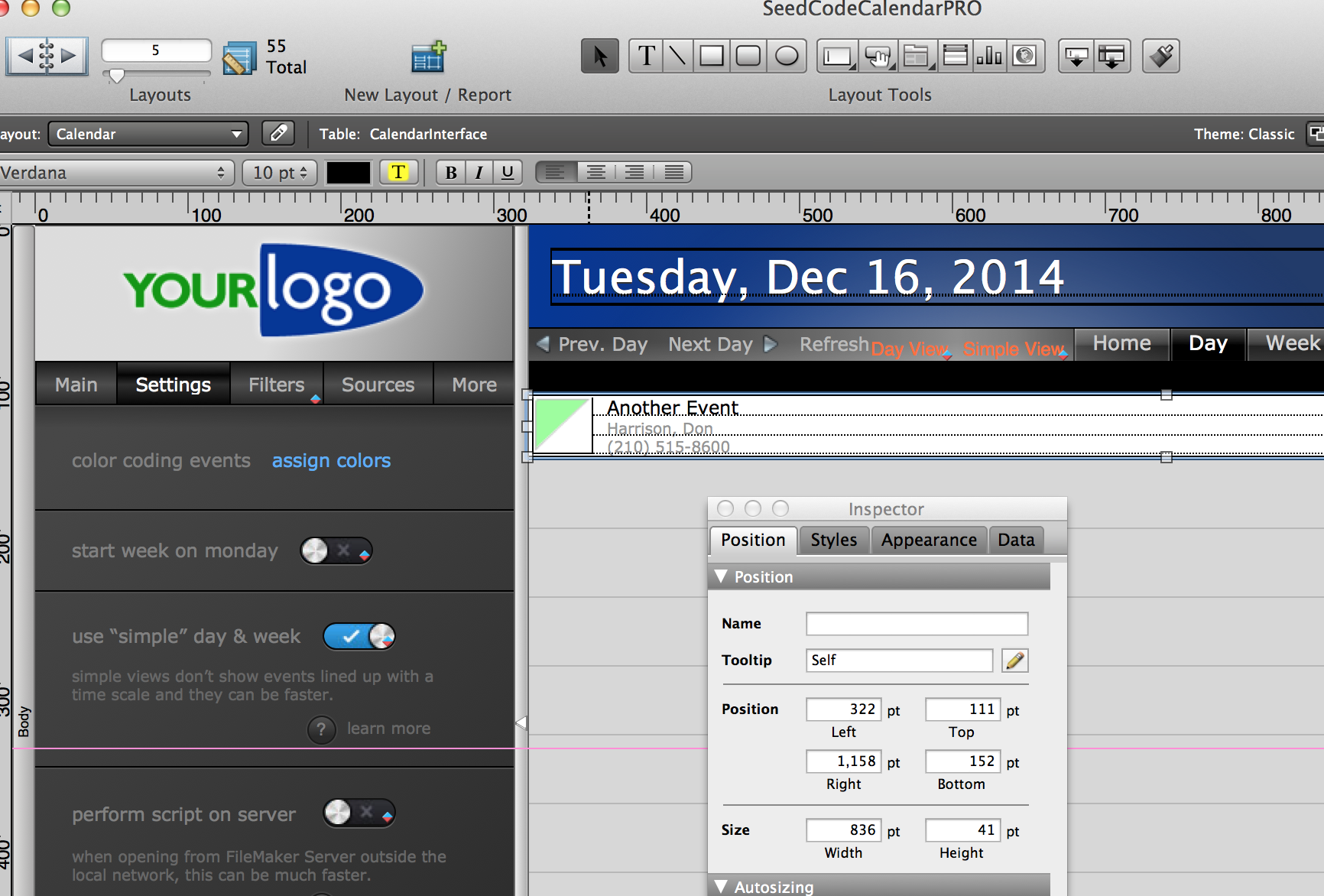

I think I didn't phrase my question clearly enough. My problem is that I can't seem to find the appropriate field (or object) to edit.
When I have the Calendar layout open for editing, I select what looks like the calendar row, but the inspector shows that object to be without a name or tooltip:
editing.tiff
editing.tiff (89.99 KiB) Viewed 39844 times
So I'm wondering what I need to do to locate and select the correct object.
Hope this is clearer. Thanks!
Jim
PostPosted: Tue Dec 16, 2014 11:51 am
It looks like you attached an image but I can't actually see it for some reason. The tool tip is attached to the CalendarRows::CalendarContentReptCalc field in the simple day view portal. I'm attaching a screen shot to show you.
