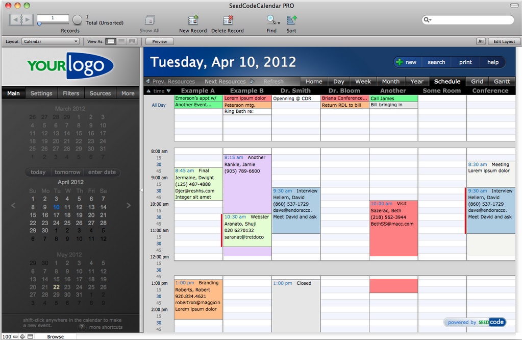

Hi There,
I'm looking for a bit of advice regarding a largely cosmetic modification: a shaded out lunchtime area. I've attached a quick mock-up of what I mean.
I expect that there is no straightforward way to do this, but I thought I'd just check if anyone else has done this successfully, or has any ideas?
thanks!
calendar break.jpg (199.74 KiB) Viewed 16400 times
PostPosted: Thu Sep 25, 2014 11:53 am
Try modifying the conditional formatting on the CalendarContentReptCalc field to this (the first line is what's already there, so just add the second line):
PatternCount ( $$sc_Mode ; "Sched" ) and CalendarRows::RowNumber = $$sc_RowsForAllDayEvents + 1
or Hour ( GetAsTime ( CalendarRows::TimeDisplayCalcs ) ) = 12
Then for the darker gray border, select the CalendarBlankRepsGlob field (1 px high at the bottom edge of the portal), and add the following two lines to the SECOND conditional-formatting rule:
or GetAsTime ( Extend ( CalendarRows::TimeDisplayCalcs ) ) = Time ( 11 ; 45 ; 0 )
or GetAsTime ( Extend ( CalendarRows::TimeDisplayCalcs ) ) = Time ( 12 ; 45 ; 0 )
Let me know if that does the trick. -Jeff
