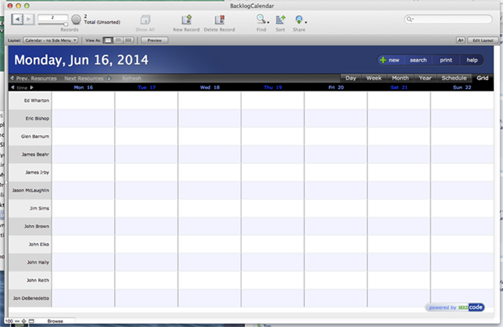

Sorry I have not been more clear. A Screen Shot is included. Lets say I have 24 Resources but can only show 12 at a time. To print all this, I need to print one page, Click the button "Next Resource" and t hen print the second page. I would like to print all the Resources at one time in a single PDF instead of two.
Can this be done with a Script or do I need to make a separate layout for Printing. If so, how do I get the Print Layout to show all the Resouces instead of the 12 I am setup for? What is the best way to do this?
Thanks... Rob
PostPosted: Mon Jun 16, 2014 8:19 pm
Sorry about all the confusion. I thought you were saying a stock Grid View shows MORE than the 12 resources you have. That it does, as there are 23 rows in the stock file. If you have more than 23 resources and you want to see them all on one screen, you can simply increase the number of rows shown on that portal, then either make the window taller or add a scroll bar to the portal. The "Print" feature is pretty simplistic; it basically just prints the layout you're on, with some objects hidden. So if you increase the number of visible rows for that portal, you should see the same number of rows on the printable view. I suppose you would just be limited by your paper size. HTH... Jeff
