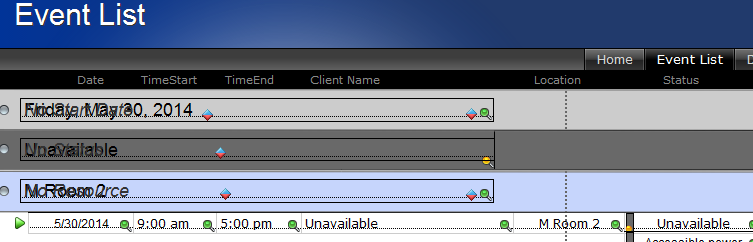

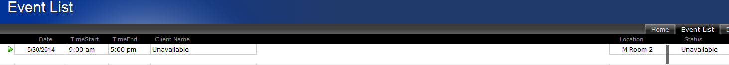

On my Event List Layout for some reason I have a really large space in the middle but I don't see a reason why when I go into the Layouts view.
Normal View.PNG (27.17 KiB) Viewed 11005 times
Layout View.PNG (37.32 KiB) Viewed 11005 times
Any ideas?

Thanks for the screen shot... See that white space beneath the date etc in the "body" part of the layout in layout mode? That's the issue. The body should only be 21 px tall to show no white space OR any objects in the body taller than 21px should have their sliding set to "up" and "also resize enclosing part" turned on. Both settings are on the position tab of the inspector under "Sliding and Visibility".

I actually just realized, I think it's stretching to fit my screen, when I hit print it shrinks back down.
