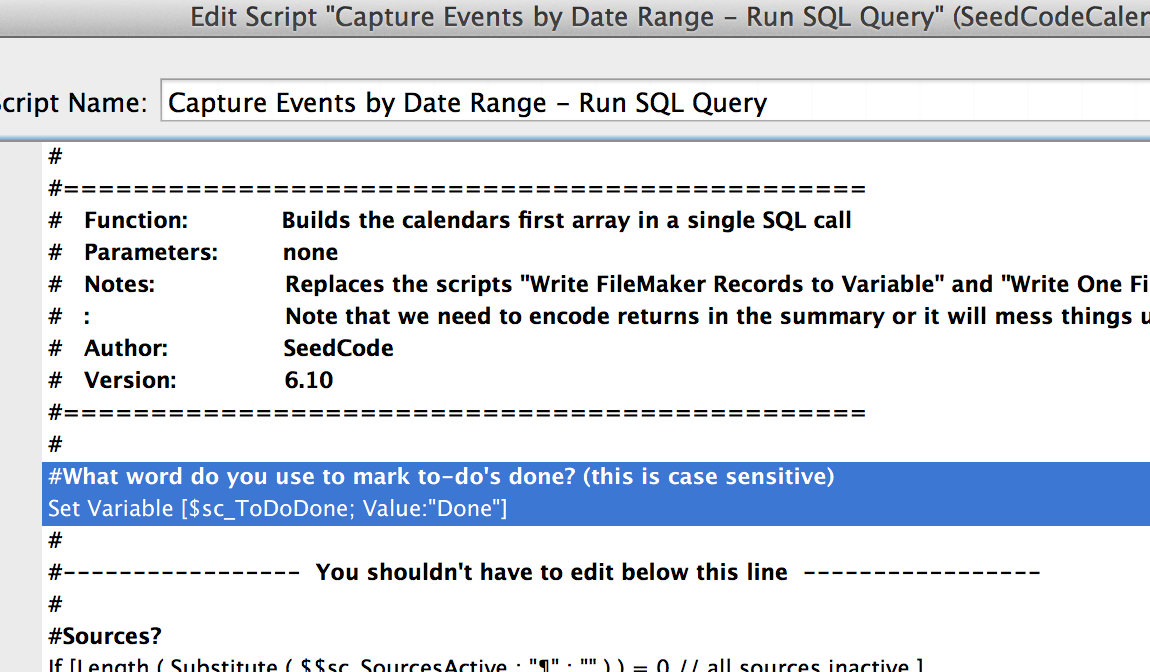

Hi Tony. The only change you should need to make is to change the value given to the $sc_ToDoDone variable in the "Capture Events by Date Range - Run SQL Query" script from "Done" to "Closed" (see screen shot). Let me know if that does the trick. -Jeff
Screen Shot 2014-03-11 at 10.15.33 AM.png (144.24 KiB) Viewed 8859 times

Thank You Jeff for that solution and the quick reply. That was it, working fine now.
