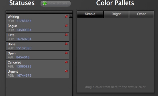

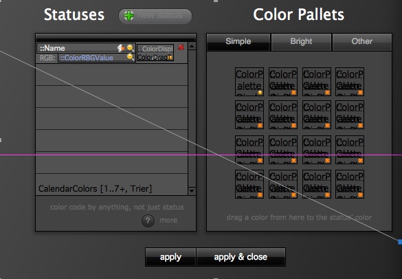

I managed to integrate SeedCode in my data file, and it seems to work, but I am unable to complete an usable "assign colors" procedure, and I do not know where I "bugged" despite my long trials to understand this failure, and to see what differences exist (where ? in tables, in scripts, in layouts ?). Here are 2 pictures of the layout for color status definitions, the one of SeedCode, and the one of my integrated (?) file.

Hi Pierre. I'm not sure what you're saying the problem is. Can you send more details? We have lots of documentation on our website to help you with your calendar integration. You might start here:
http://www.seedcode.com/pmwiki/pmwiki.p ... tionColors

Hi Pierre,
The two empty fields on the left should be getting populated when the script Load Calendar Graphics gets run as part of the start up routine. Those are text characters that we use for the color fill and stripe in the Simple Calendar.
Upon Opening > Load Calendar Settings - On Startup --- Edit Configuration Here --- > Load Calendar Graphics
so maybe something's not right there. Please run the script Load Calendar Graphics manually and see if that corrects the issue. If it does, check that script path starting with Upon Opening and make sure Load Calendar Graphics is getting called.
We sometimes run into font issues, but that doesn't look like the case here as the layout versions of these objects are all showing on the right.
Let me know if that helps!
If not, we can take a peek at the file and see if we can figure out the issue. Send us an e-mail at support@seedcode.com and we can get that set-up.

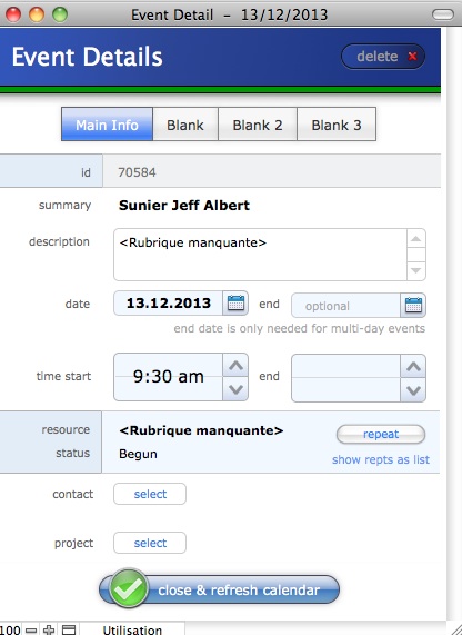

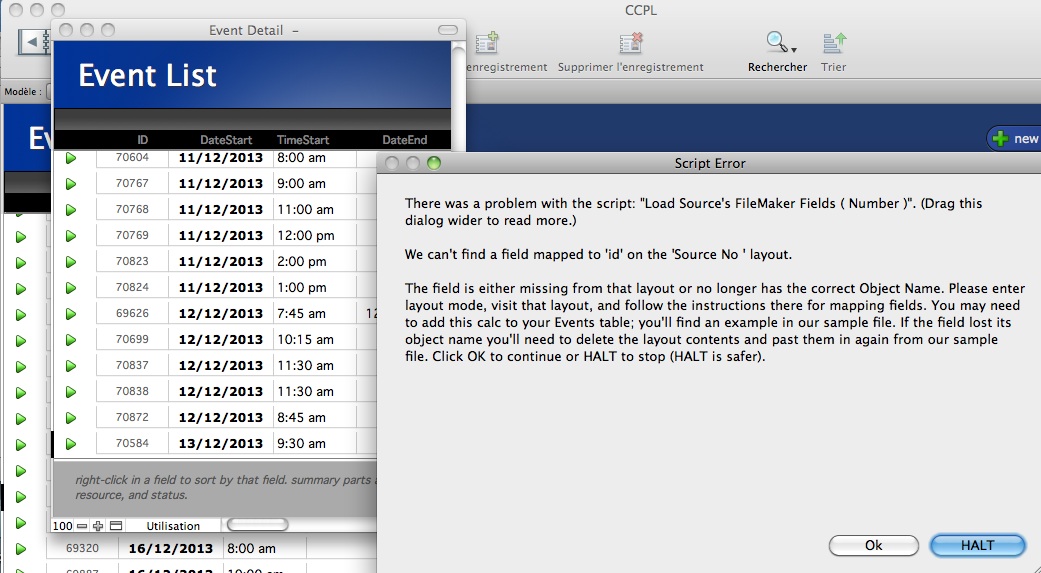

I dare to publish here ANOTHER PROBLEM that appeared. It is the question of visualisation (or edition too) of my Event Details in the small pop-up window). When this window is triggered
- by clicking on the event in the Calendar: everything OK
- by clicking on the small green triangle on the left of the same event, in Event List view) I get the Event Details pop-up window, but not showing the event details in proper format (layout) but again a list of events, as in Event List view (=layout) !!!
I do not understand the problem, neither exactly what I should change. My field mapping is OK I think (Source No 1). Here is what I get, first by clicking on an Event List event (green arrow on the left) , then by clicking on a Calendar event .
Event Detail triggered from Event List.jpg (185.13 KiB) Viewed 19570 times
Event detail triggered from Calendar views.jpg (70.59 KiB) Viewed 19570 times

PostPosted: Wed Dec 18, 2013 6:07 am
Hi Pierre. Thanks for sending in your file. Looks like the button object on the Event List layout is just missing the required parameters.
Should look like this:
"SourceNo = 1 ; ID = " & SampleEvents::id & " ; DateStart = " & SampleEvents::DateStart
// ...using your fields. =)
