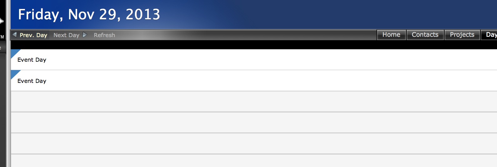

Hey Guys,
I've had a quick look around, and was wondering how I would go about adding another bit of information to the day view, shown below.
Ideally I'd like to also display the related project name, I've had a quick search through the scripts and layouts, and wasn't able to figure out how it would be done ?
Screen Shot 2013-11-29 at 19.06.28.jpg (79.06 KiB) Viewed 4491 times
Thanks in advance
James
PostPosted: Fri Nov 29, 2013 1:43 pm
Hi James,
You probably want to edit the field mapped to the event's description using return separated values to show more info. That and a couple other strategies are described here: http://www.seedcode.com/pmwiki/index.php?n=SeedCodeCalendar12.AddingFields
