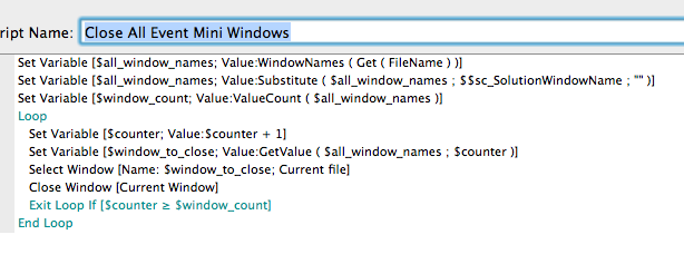

Now I'd like to be able to close all Event Windows but not immediately after jumping to my Event, I'd like to close them later on.
I tried to copy-paste a portion of your script "Jump to related Project's Layout (Project ID)" and enclose it in a loop as follows:
The script works but only if the selected (highlighted/current) window is one of the Event Windows.
If the current window I'm working on (!= Event Window) calls the script in the figure attached nothing happens.

I'm glad you're enjoying using the Calendar! How about this for your script?
Screen Shot 2013-10-08 at 11.01.51 AM.png (36.33 KiB) Viewed 6810 times

Thank you very much jeffalmquist, your script works like a charm.
I just added as first line an "if" to prevent closing the only open window since in my solution the script could get called without any Event Mini Window open
if [ValueCount ( WindowNames ( Get (FileName) ) ) ] > 1;
-jeffalmquist's Close All Event Mini Windows-
End if;
