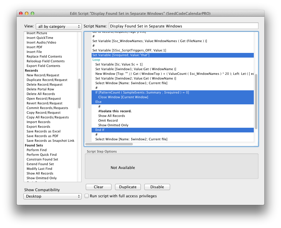

Hi Jan. Try modifying the "Display Found Set in Separate Windows" script as shown in the attached screen shot. The highlighted steps are ones I've added to close the Event Details window if it doesn't match the required criteria. -Jeff
Screen Shot 2013-09-25 at 7.52.54 AM.png (158.54 KiB) Viewed 9046 times

Thank for this one, I tried it today, but I 'm afraid it doesn't really do the trick either. It will close the first of two found EventDetail windows, but leave the other open on screen. I'm not that good at troubleshooting this, the "Display Found Set..." and "Click in / Drag Event" scripts are pretty complex. My feeling is that the loop in the "Display Found Set" script, within which I try to execute some sort of an "ownership" test exits too early, because the exit condition is met (FoundCount=1), after closing the first window. From then on, I'm kinda stuck ...
