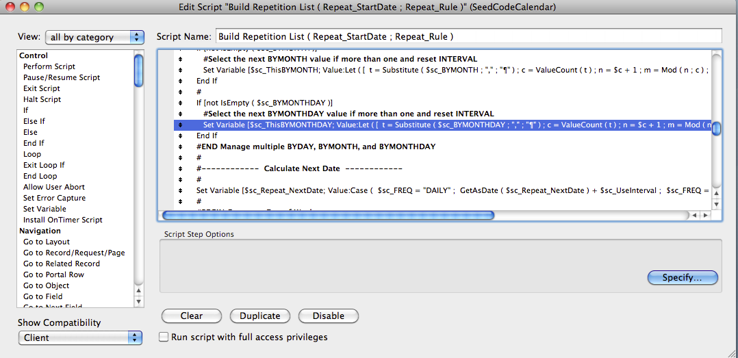

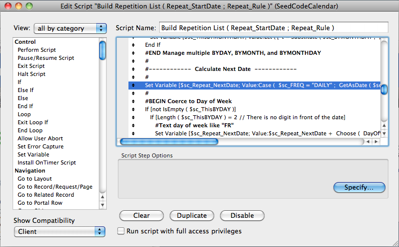

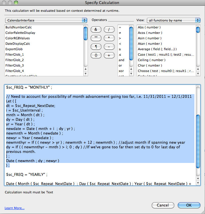

Here's how you can fix this behavior in your file. In the "Build Repetition List ( Repeat_StartDate ; Repeat_Rule )" script, you need to adjust two Set Variable calculations. I'm attaching screen shots to show you where all of this needs to happen and what it needs to look like. I'm also pasting the code for one of the edits so you can just copy/paste it into your file:
// Need to account for possibility of month advancement going too far, i.e. 11/31/2011 = 12/1/2011
Let ( [
dt = $sc_Repeat_NextDate;
i = $sc_UseInterval ;
mnth = Month ( dt ) ;
dy = Day ( dt ) ;
yr = Year ( dt ) ;
newdate = Date ( mnth + i ; dy ; yr ) ;
newmnth = Month ( newdate ) ;
newyr = Year ( newdate ) ;
newmnthyr = If ( ( newyr > yr ) ; newmnth + 12 ; newmnth ) ; //adjust month if spanning new year
dy = If ( ( newmnthyr - mnth ) > i; 0 ; dy ) //If we've gone too far then set dy to 0 for last day of previous month.
Date ( newmnth ; dy ; newyr )

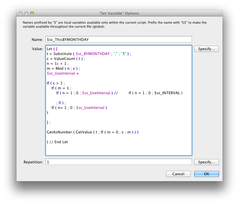

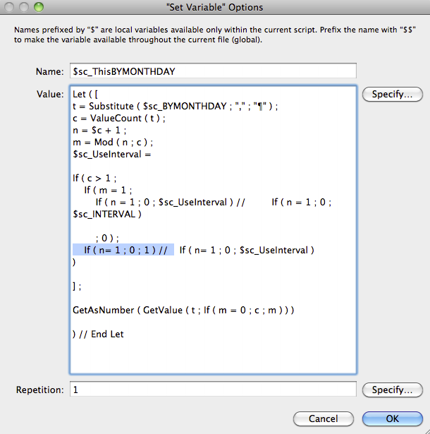

I located the script and first variable edit (the one with the large copy-and-paste change) with no problem and made the update. However the second edit you specified in the same script already had
If ( n= 1 ; 0 ; 1 ) // If ( n= 1 ; 0 ; $sc_UseInterval )
for
$sc_ThisBYMONTHDAY
so there was no change to be made.
This is for the FMP 11 version. The single edit I made did not fix the problem, most likely because I was not able to make the second edit. Did you perhaps make a different second edit?
Thanks.
PostPosted: Wed Aug 28, 2013 6:26 pm
I'm VERY sorry. The mistake was that my second instruction wasn't clear at all. You need to DELETE the code you see highlighted in that screenshot, so the Set Variable value should look like this new screen shot. Give that a try and let me know if it works.
