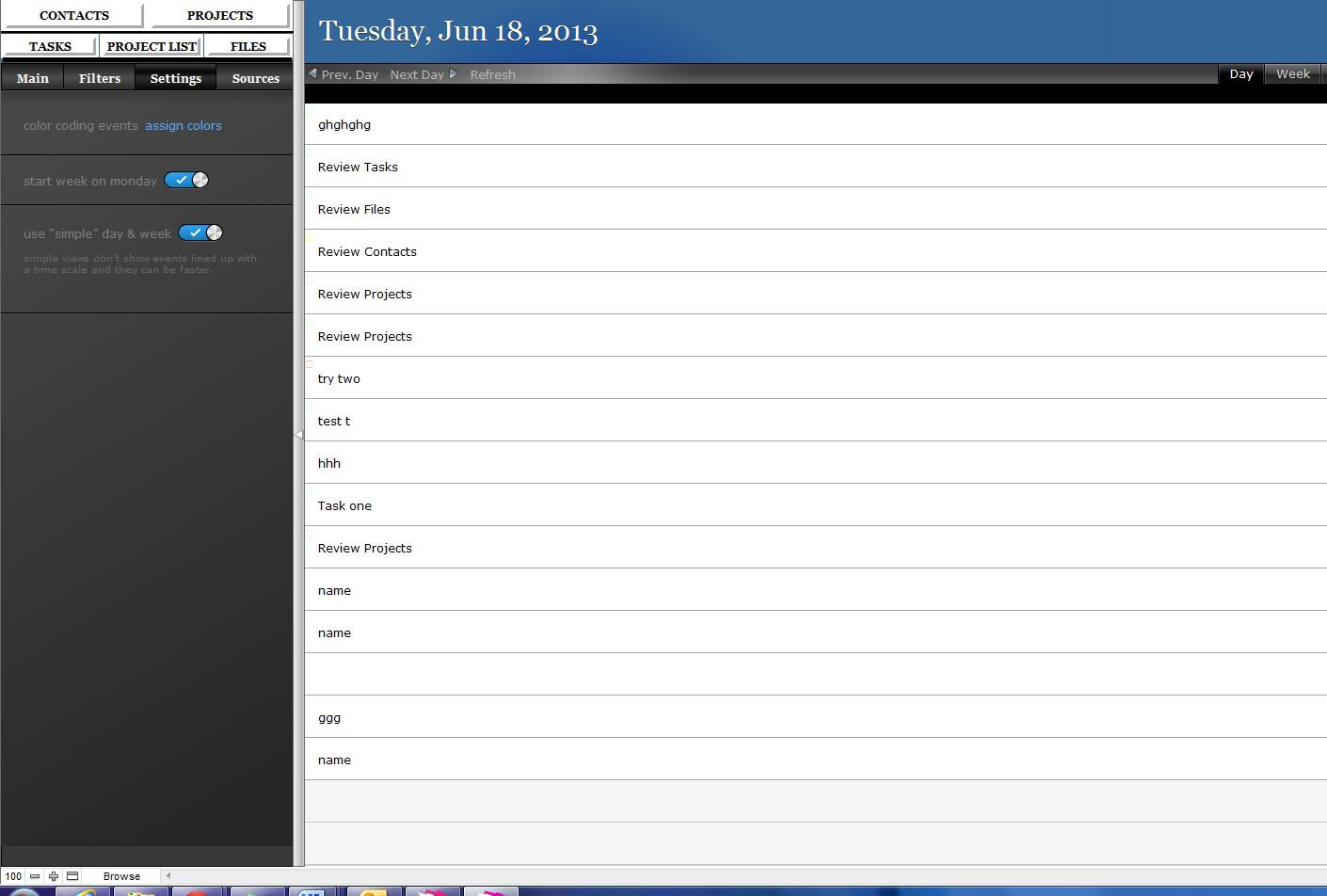

The event colors are not showing up on my calendar when I switch on the simple view, but only for the day view. The week simple view shows the colors fine and everywhere else on the calendar. All I see for the simple view is the box lined with the color but it is blank inside.

Of course. Attached is a screenshot of the simple day view. Can this be fixed?

PostPosted: Tue Jun 18, 2013 9:11 am
Hi Iris. The field that displays the small color triangle in the upper-left corner of each row in Simple Day view is the CalendarRows::CalendarColorReptCalc field. It's a calc that references the CalendarColorGlobTriangle, CalendarColorGlobBar, and CalendarColorGlob fields, depending on your computer platform (Mac vs Windows) and current view (day, week, etc.). Go to the Calendar Records layout and make sure those other fields are populated with the right graphic objects. If you can't figure it out, go ahead and send me your file and I'll have a look.
