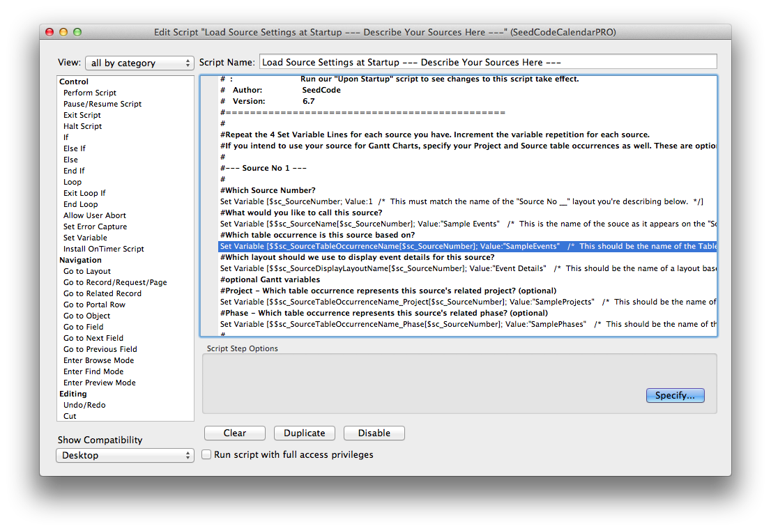

After I renamed the SampleEvent table to just Event, I encountered SQL error when adding appointment. What do I have to do to make this change?
PostPosted: Thu Jun 06, 2013 3:53 am
When you change the name of a table occurrence, you also need to edit the "Load Source Settings at Startup --- Describe Your Sources Here ---" script. I've attached a screen shot showing the line where you need to make this change. Also, here is our online document that covers this question:
http://www.seedcode.com/pmwiki/pmwiki.p ... mingTables
Screen Shot 2013-06-06 at 5.50.07 AM.png (237.69 KiB) Viewed 6003 times

Thank you
