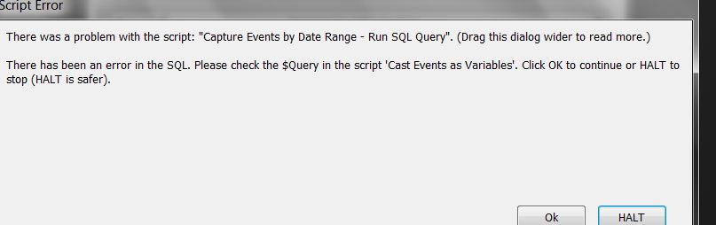

Fig i try FM12 version... not that hard to link FM11
but seeing some new stuff.. and causing me a error..

Hi Ron,
The most likely causes of a SQL error like this is either incorrectly mapped field objects on your Source No X layout(s), or incorrect variable settings in the "Load Source Settings at Startup --- Describe Your Sources Here" script. Double check all of those things the re-run the Upon Opening script, and see if that gets rid of the error.

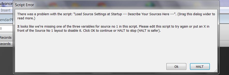

review review/// video and doc.. all steps
Removed Gantt and extactly like vid
Getting new error msg..
Confused about source 2 maybe my problem with termology?
My application linked to is mC_RemoteAgent.fmp12
Its event file worked on FM11 version... but i inspected field's for any changes// esp z start and zend tha calcs the event filed into a number
No really clear if i am supposed to insert mc_remoteAGent to these or all field... instructions unclear
script loading resouces error suggest me look

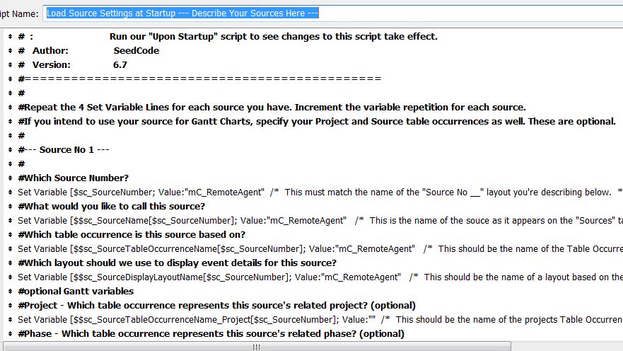

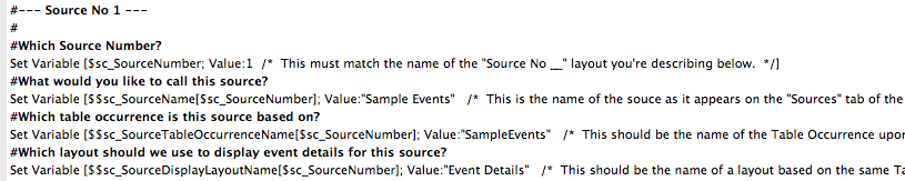

PostPosted: Fri Apr 12, 2013 5:26 am
Hi Ron,
In the "Load Source Settings at Startup --- Describe Your Sources Here ---" script, make sure the variables in the section shown in the attached screen shot are being set properly, according to the names you are using for source number, table occurrence and layout name.
Jeff
Screen Shot 2013-04-12 at 7.22.41 AM.png (47.54 KiB) Viewed 6967 times
