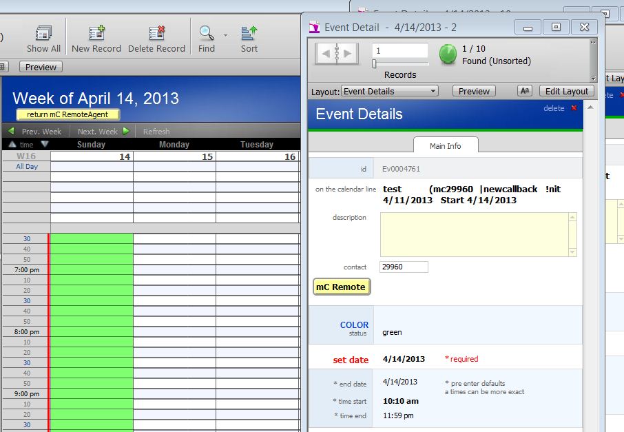

YO FOUND THE ANSWER... my eyes.. looking all those times...did not on left side see up/down arrow so much black on black
but the events are colored green view normally in month view...
in DAY WEEK... it solid green.. can't see Line one of calender whereas i can in Month view?? see image attached

PostPosted: Thu Apr 11, 2013 1:21 pm
Hi Ron,
Lots of things could be causing that green area on your calendar. My guess is there's a problem with either the position of some of the layered objects in that portal, or the stacking order is wrong. Both of those things can happen pretty easily without you even realizing it. You should probably copy/paste that portal and its contents from a recent backup and re-apply any changes you've made in the meantime. Otherwise it can be pretty tedious to try to unravel.
When you turn "Simple View" on, you're actually going to a different tab panel and portal, which explains why you aren't seeing the same problems there.
To change the default view when you open the calendar, just change the subscript that runs toward the end of the "Upon Opening" script.
