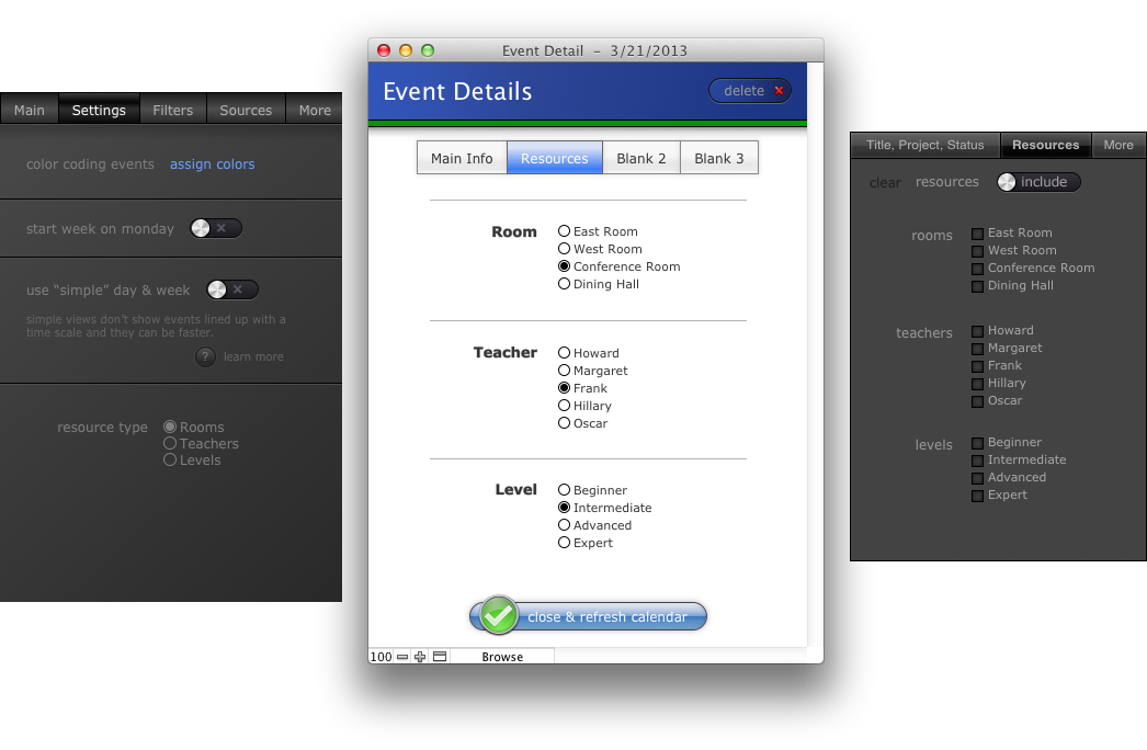

4. Place the "ResourceTypeGlob" field on the Settings panel in the sidebar on the Calendar layout, format it as radio buttons, and assign it the "ResourceTypes" value list. Set up an "OnObjectModify" script trigger on that field to run the "Run Resource Filter" script. (see attached image)

1. Open an event in the Event Details popup window, go into layout mode, and go to one of the unused tabs. Draw a field object and associate it with the Resource field. Format the field as radio buttons and assign it one of your resource-type value lists (Rooms). Then repeat that process for each of your other resource-type value lists (Teachers and Levels). So you'll end up with three instances of the Resource field, each associated with a different value list. Label each instance accordingly, and name the tab you're on "Resources". (see attached image)
2. If the Resource field still appears on the "Main Info" tab of your Event Details layout as an edit box or drop-down list, you should remove it to avoid confusion, because from now on the Resource field will contain a list of return-separated values.

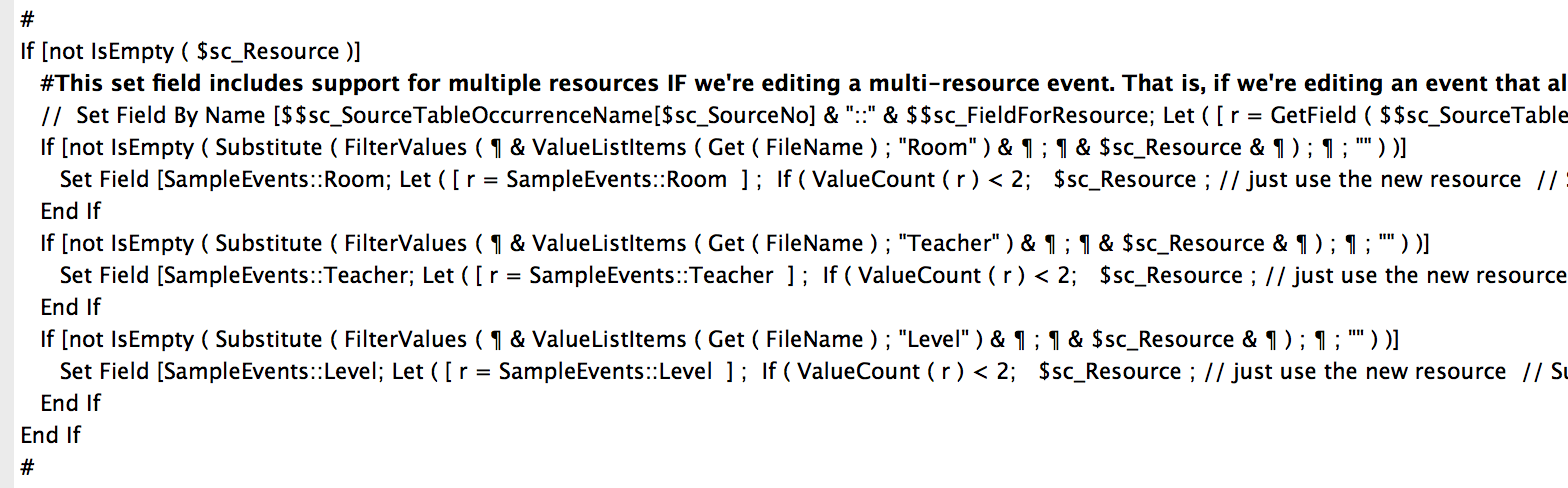

3a. If you use this "separate fields" scenario, there is one more set of scripting modifications you'll need to make in order to use drag-and-drop to move events between resources on the Schedule view. Drag-and-drop will appear to work at this point (the event will move to the correct new column because the Resource field will have been updated), but don't be fooled. The actual data fields (Room, Teacher and Level) will not have been updated. To fix this problem, open the "Create Edit Delete Event…" script and look within the If [not IsEmpty ($sc_Resource)] nest, immediately following the "This set field includes support for multiple resources…" comment. Disable the "Set Field By Name" step and add three new "Set Field" steps here to update the Room, Teacher and Level fields directly, and wrap each in an If [] statement to determine whether the value associated with the target column appears in the value list that is associated with that field. You can copy the calculation code from the original "Set Field By Name" step, and you only need to change the field that is referenced in the first line (r = YourTable::Room, r = YourTable::Teacher and r = YourTable::Level).

1. To enable filtering based on your multiple value lists, go to the Filters > Resources tab panel in the sidebar and associate the FilterGlob_3 field with the "Rooms" value list.
2. Duplicate that field object and associate the copy with the "Teachers" value list, and then do the same for "Levels". So you'll end up with three instances of the FilterGlob_3 field, each associated with a different value list. Label each instance accordingly.
3. Format these field objects as checkboxes (or popup-menus, if the lists are too long), and resize them as necessary.

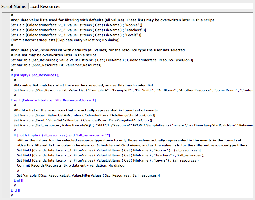

3. Edit the "Load Resources" script so it looks like this:
The updated "Load Resources" script
Here's the code you'll need to set that $all_resources variable:
ExecuteSQL (
"SELECT \"Resource\" FROM \"SampleEvents\" where \"zscTimestampStartCalcNum\" Between " & $start & " and " & $end &
"Union
SELECT \"Resource\" FROM \"SampleEvents\" where \"zscTimestampEndCalcNum\" Between " & $start & " and " & $end &
"Union
SELECT \"Resource\" FROM \"SampleEvents\" where \"zscTimestampStartCalcNum\" < " & $start & " and \"zscTimestampEndCalcNum\" > " & $end ; "!~!" ; "¶" )

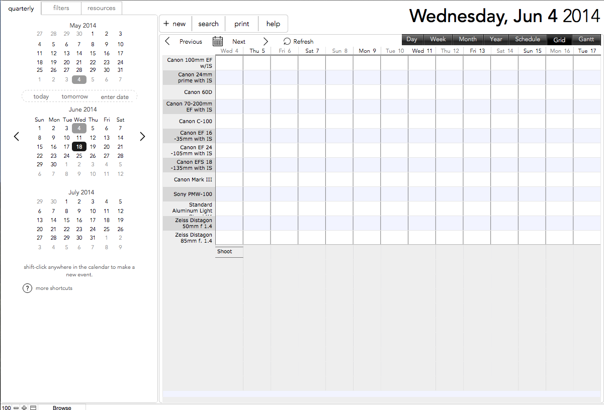

So, I have worked through this tip, since I do have multiple resources, and my column headings in GRID view and row names in SCHEDULE view work perfectly. What doesn't work is the cells. I get my one scheduled resource under the GRID view and it doesn't appear at all on the SCHEDULE view.
I am sure that this is a user-problem, but have run out of things to test. It appears that my resource field on the layout Source No 1 is populated correctly. The scheduled item appears on the calendar layouts. The resource data is stored, though is obviously a multi-key as suggested by this post. I have included a screen shot so you can see what I see.
My forehead is a bit flattened from trying to figure this out, and I am hoping that you have seen this a "million" times before and will know the answer quickly.
*susan*
p.s. If I copy your layout from the original, untouched version, I also see my data hanging down below.

PostPosted: Wed Jun 18, 2014 12:24 pm
Hi Susan. I'm not what's going on. You might try testing a copy of your file with simplified resource values (without the dashes, slashes, periods, etc.) I don't know that those things are problematic but I'd like to rule that out. Let me know how that goes.

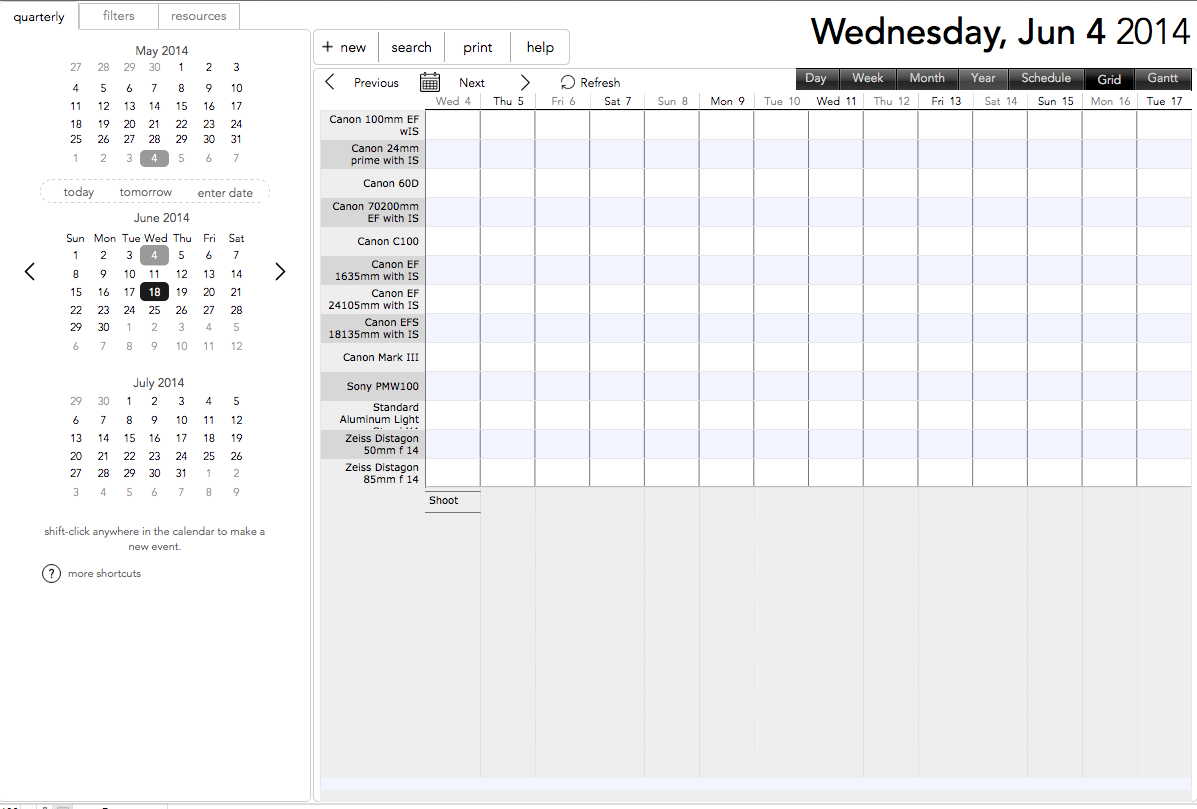

No change in the behavior. I removed all the non-alphanumeric values, reran the Upon Opening script and confirmed that the new values were present.
I have attached a redo of the original screen shot, and one in layout mode to show that I don't have any fields trailing below.

PostPosted: Wed Jun 18, 2014 1:23 pm
Still not sure what's going on. It could be data-related. I'd be happy to help you troubleshoot if you don't mind sending your file with full-access login info to me at support@seedcode.com
Posts: 4
Joined: Wed Jun 18, 2014 7:28 am
PostPosted: Thu Jun 19, 2014 11:50 am
Thanks Jeff for the offline help!
In case someone else ever sees this, check for trailing paragraph returns in your resource field.
PostPosted: Fri Jun 20, 2014 10:59 am
Correct - the culprit here was a trailing carriage return in the Resources field.
