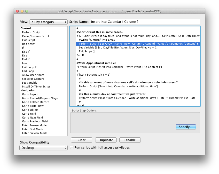

Hi Damian,
I assume you're talking about changing the word "more" to "mas", si? I'm attaching a screen shot to show you where you can do that. It's in the script parameter of the selected "Perform Script" step.
I hope that helps. Let me know if you have any other questions.
Jeff

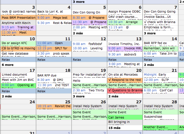

PostPosted: Thu Feb 21, 2013 1:48 am
Thanks, I've modified the Script "set array..." and the monthly calendar shows "2 más" but "3, 4... etc. more"
Should I change more steps?
Here is the image, thanks

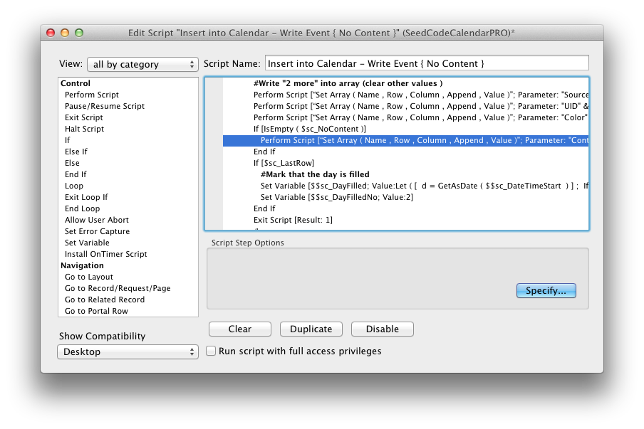

PostPosted: Thu Feb 21, 2013 6:25 am
Hi Damian,
Sorry about that. Yes, you have to make the same change in the script parameter for the "Perform Script" a few lines down as well. I'm attaching another screen shot.
Jeff

PostPosted: Thu Feb 21, 2013 9:58 am
Thanks Jeff, but I made both changes and the problem persists even in the original file: SC v6.23.
Sometimes the word "más" appears, but also sometimes the word "more". Look at my screen shot.
Damian

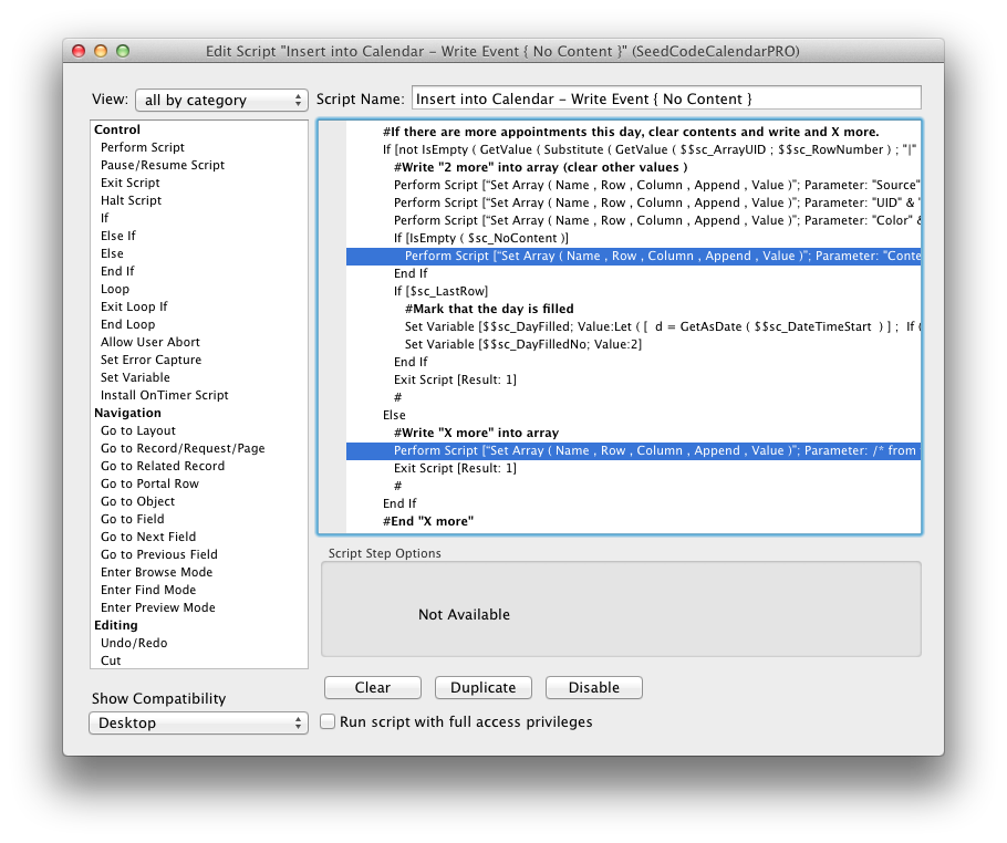

PostPosted: Thu Feb 21, 2013 1:06 pm

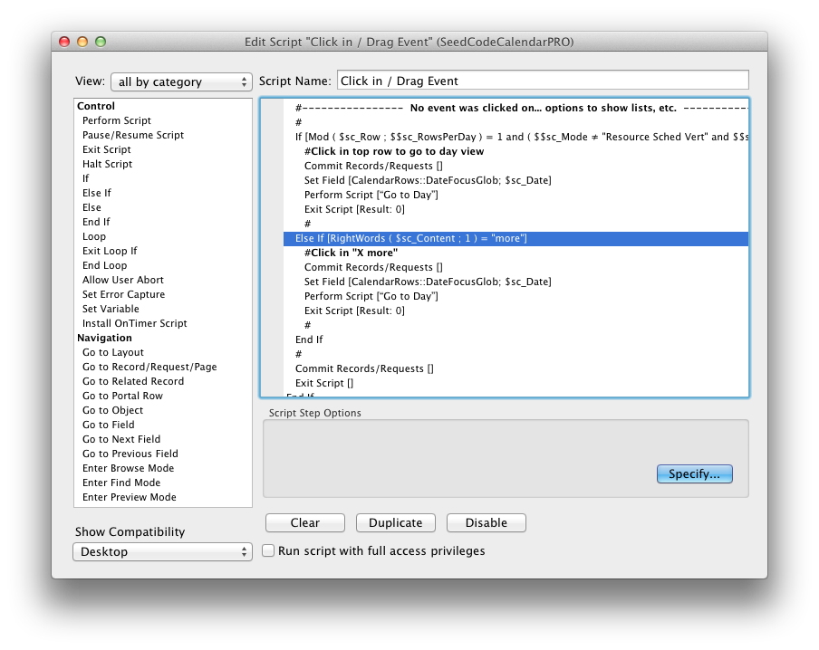

Your calc is correct. Turns out there's one more place where this change needs to be made, and it's in the "Insert Into Calendar { Column }" script - see attached screen shot. Sorry for all of the back-and-forth on this.
You'll also want to change the "Click in / Drag Event" script. You'll see in the second screen shot that the script looks for the string "more" to know where you clicked. So just change "more" to "mas" there too.
